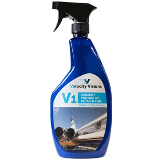

VELOCITY VISIONS AIRCRAFT V1 PROTECTIVE DETAIL AND SEAL
(Click image for a larger view)
Make Selection(s) Below To Order
From $29.95 to $320.00
Size:
Select Size:22 ounces1 Gallon5 Gallon
Part Number:
Quantity:
Velocity Visions V1 Protection Detail and Seal is an easy spray on and wipe off sealant that is extremely hydrophobic and glossy. It is formulated to bond and protect the aircraft exterior from harsh elements, fuel and oil leakage, ice build up, UV rays and much more. It can easily be applied in a matter of minutes.
