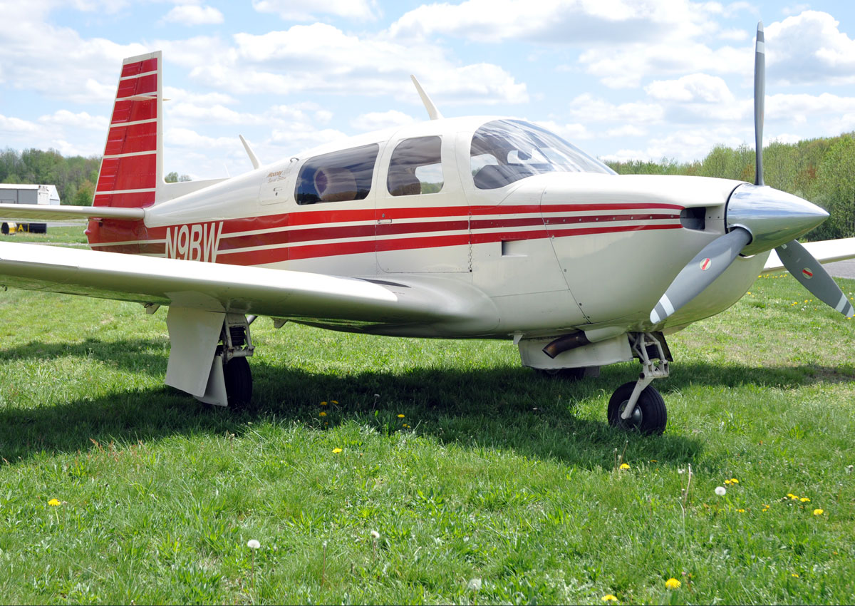

There are examples that appear to be either skins added or just painting the glass.   Anyone have experience with this?  Yes, I know it is not the perfect solution, but we are flying "vintage" airplanes.  I see it as a two step process, change the outside and then make the inside match later.  I fly a 75', the interior is bad plastic from the era.
Look close at the edges of the windows and you can see the additions.
http://www.airmodsflightcenter.com/sites/airmodsflightcenter.com/files/forsale/N9BW/N9BW_0969-a.jpg

I took a flight in a rocket not long ago. It had rounded corners in the windows. It was some kind of tape like a vinyl decal that was painted the same color as the plane. I thought it looked pretty good. You had to get with in 5 feet and look real close to notice it wasn't original aluminum.

I priced out replacing the window skins in my 77 J during my 3 year resto. I gathered up all the p/n from the parts manual and sent a couple of quote requests out for the skins. I believe I was $1200. Almost $600 alone to replace the door skin. Next time look closely around your windows and doors and add up all the rivets you would have to drill out and re-do. IT'S NOT EVEN CLOSE TO PRACTICLE. Promise!!! Vinyl corner inserts are about as good as it gets. My opinion if you want the oem rounded corners by a newer mooney. ;)
