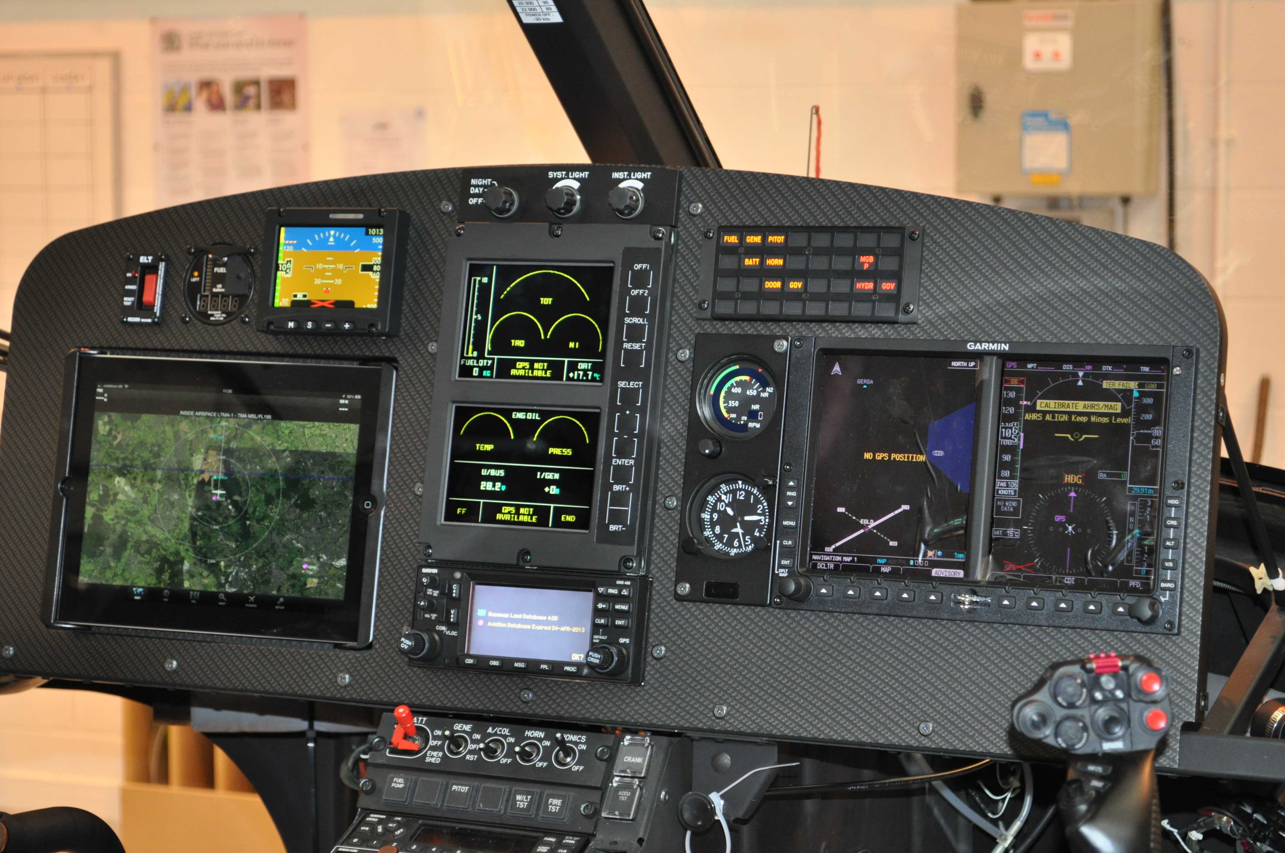

carl Posted March 8, 2016 Report Posted March 8, 2016 Carbon looks cool . What are the FAA rules. Can we do anything we want . I saw some carbon fiber interior panels once and wondered how do we do that.
