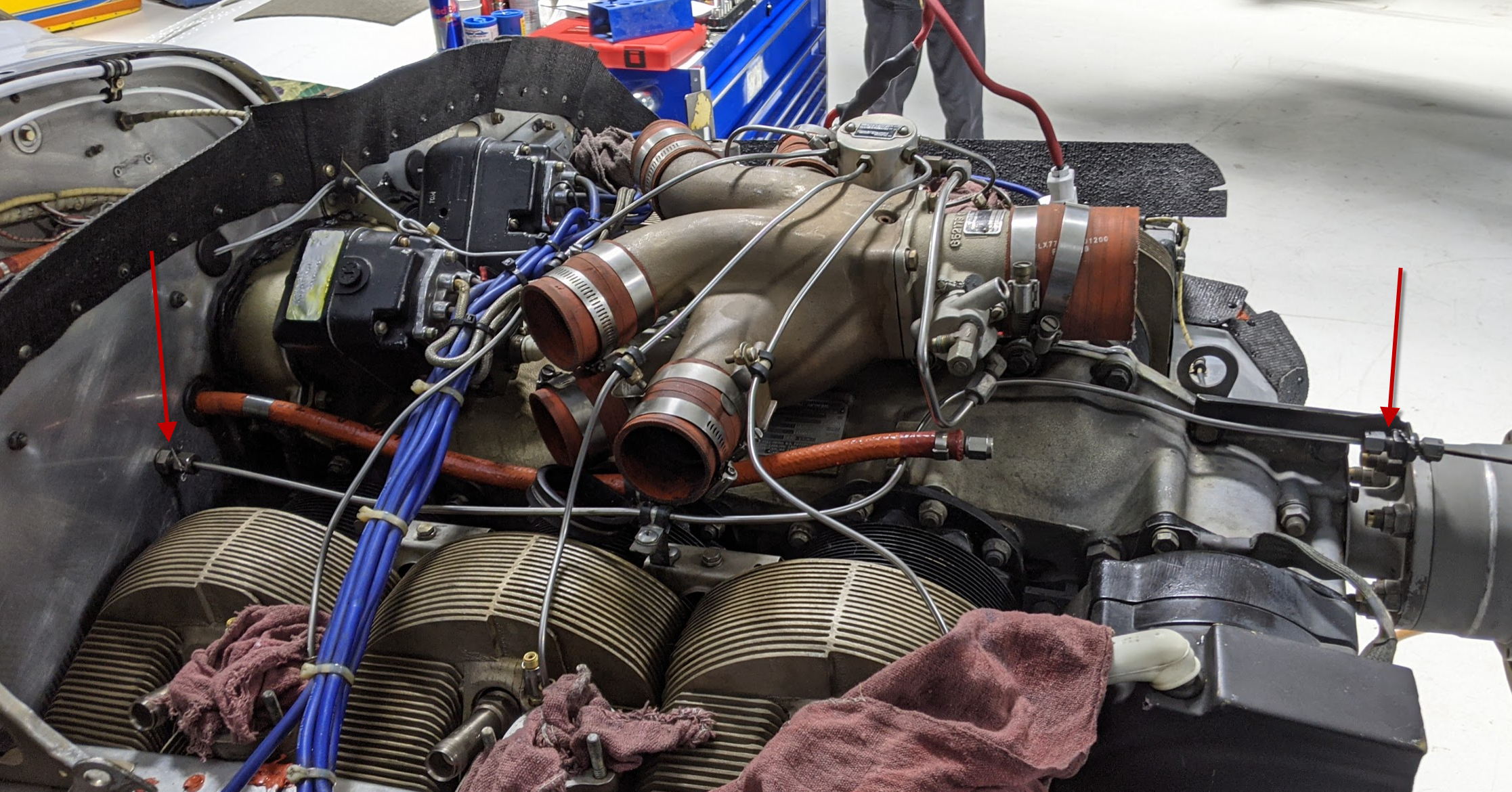

I am late to the party here, but have my motor a bit taken apart and had a chance to get some good pics. Maybe they will be helpful for someone.
Red arrows show the fittings that the TKS fluid passes through, assuming that the hose isn't broken, I would guess its leaking from the baffle fitting of the fire wall fitting.
