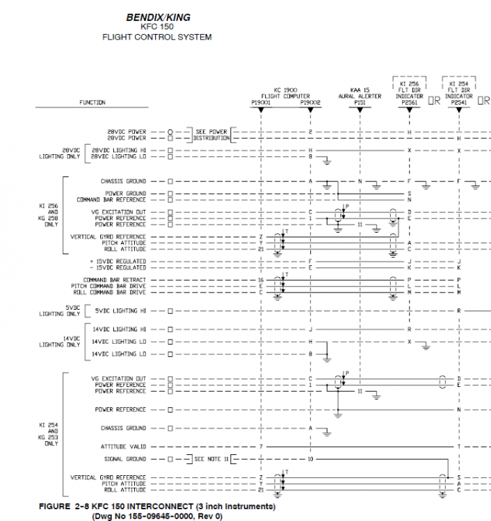

There isn't a huge difference between the KAP 150 and KFC 150 autopilots.  The only difference is the flight director.  The aspen is built to simulate the KI 254/256 and can use the same commands to drive the flight director.  It should only be a handful of wires added to add the flight director function.
Here are the connections from the KFC150 the KI indicator.
And, here is from the Aspen manual showing which connections are needed for the flight director.
It should relatively easy (of course it is a Mooney and the panels can be a nightmare to work on) to add the five wires that support the flight director operation.  The flight director adjustment is done through two small adjustment pots that can be accessed through the front panel of the KFC150.

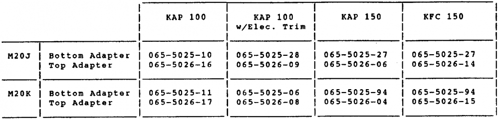

And I would say if you don't want to go for it, let me know, and I will give it a shot! I had looked at this similar topic when installing an Aspen 2000 MAX system. I do know that you can't just take any 'ole KFC and swap out the box, as there are 'chips' inside calibrated to the different airframe models (Mooney, Piper, Cessna, etc...) That and the voltage difference as mentioned above. If you don't want it, tell them you know someone who is.
To provide some clarification, the main difference from a KAP150 to KFC150 is the addition of FD bars and a different AI.  There is additional wiring as others have mentioned but don't forget about the voltage of the unit or the adapter chips that are airframe specific.  Depending on how the aircraft is optioned the KAS297B can be additional as well as a remote annunciator.  Also, the KC192 flight computer needs to be married/aligned to the attitude source.  This is easiest to do with the flight line tester or if the shop has built a extender harness as all of the gain pots are on the right side of the unit and you can not adjust them if they are in the rack.
I believe one of them needs to be change and I want to say it is the top module. I would have to look at the install manual to be sure.  As for paperwork I think you could use the original stc install paperwork as it covers all the KAP/KFC for that aircraft/model.  However, be sure to consult your local shop first just to stay safe.

Are you installing it in a J? The K and J have significant elevator/trim system differences (J was the last model with the trim assist bungees and the K was the first with the downspring and bobweight) so there might be different characteristics to the autopilot. The are two modules that plug into the computer PCBs that are specific to each airplane model. If switching models, you should check that the modules don't need to change, or that if they do, the modules from your KC 191 will work in a KC 192.

27 minutes ago, Jake@BevanAviation said:
For M20J/K with the KCS55A compass system.
Jake, are the adapters available from Bendix-King? If not, is there any other source?
Good luck and I say, go for it.
Warren
