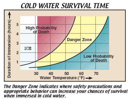

15 minutes ago, Hyett6420 said:
Bet you have never been out at sea though in those temps, 80 degrees with a nice force 4 blowing at you for 5 hours.  Hmm you would be dead.
From where he said they were flying, the water temp looked to be in the 58-65 dF range unlike the 85+ down in the Gulf of Mexico around Gulf Shores. Not much fun at all.
Did someone say Danger Zone?
