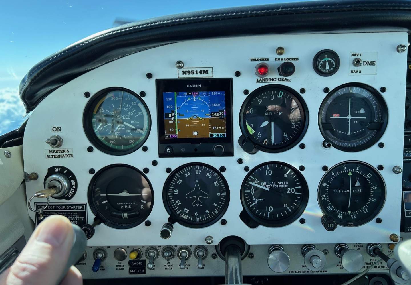

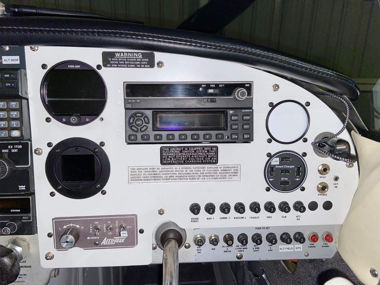

Igor_U Posted Thursday at 08:31 PM Report Posted Thursday at 08:31 PM 2 hours ago, AndreiC said: Well, since it seems there has been at least one person who did this @Igor_U, was the juice worth the squeeze? Can you perhaps share pics of the after results? I'm sure it was done on a number occasions as I remember reading about. Anyway, attached are pictures for LHS and RHS panel. Unfortunately, I don't have final CAD files I created as I used a (former) work computer. 1

AndreiC Posted Saturday at 11:23 PM Author Report Posted Saturday at 11:23 PM @Igor_U That panel is beautiful, that is the kind of thing I was hoping to get to... How many hours of work on your part do you estimate that was to install it (not counting the CAD design time)?

Igor_U Posted 7 hours ago Report Posted 7 hours ago On 10/25/2025 at 4:23 PM, AndreiC said: @Igor_U That panel is beautiful, that is the kind of thing I was hoping to get to... How many hours of work on your part do you estimate that was to install it (not counting the CAD design time)? It's hard to say but RHS panel took longer due to complete rewiring and adding new circuit breakers above the original ones. LHS panel install took probably one full weekend once the cutting and powder coating was done (Seattle powder coating). This requires some downtime in order to remove the old panel and figure out the proper layout and to assure the clearance to the structure under panel. I've done the LHS panel while waiting for the engine from the factory. I chose the off white shown as I prefer light colors and contrast provided with instruments. I used dry transfer lettering and clearcoat on RHS panel which looks great. LHS panel done later was with some self adhesive foil that you can print on and stick on the panel but I wouldn't recement them. Make shore that mounting holes are properly located and clearance holes so you can position panels correctly. At that time I used a LASAR kit for installing the flat panel. Heather did some research and provided standoffs/spacers (see below) and Lord rubber mounts for the panel. Price was less then $50.0 but some of the spacers didn't have a adequate length to place the panel to the angle required for the turn coordinator so I purchased few at McMaster Carr. I think even rubber mounts can purchased there... Some rewiring was needed as instruments have Nulite underneath the panel. Those were wired to the original pot at the ceiling and worked quite well. CAD work and selecting hardware and such was easy for me but I design airplanes for living. it shouldn't be that difficult providing you have an access to CAD software but perhaps it's the best to get the panel from a pro and install it yourself. One thing to be aware, original secondary structure needed some moderate trimming to clear the ASI al the way at left top corner. If you look at the first picture posted by 47U, it will be self-explanatory. Good luck.
