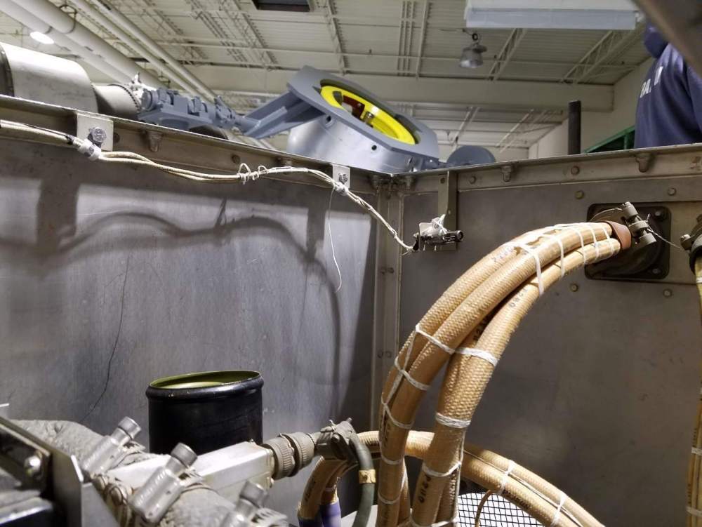

This is what a thermocouple-style discrete detector looks like.   The thing poking through the wall in the first pic, and on the end of the wire harness in the 2nd.image.thumb.jpeg.9b9f84f173bd2881e6bc1fbb4737f7a5.jpeg

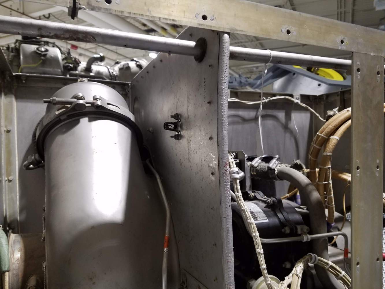

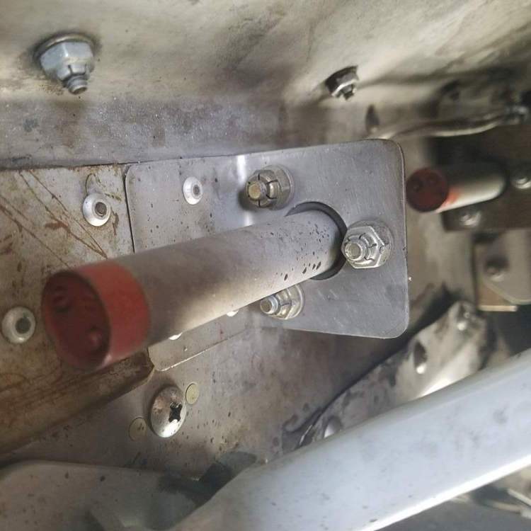

On 4/11/2022 at 10:42 AM, Fly Boomer said:
Can any of our Rocketeers identify this?  It's pretty far forward and under the turbo:
And two more (similar/identical) down low, starboard side, on the firewall:
Appreciate any help.
Thanks,
John
Those are fire detectors right out of a Cessna Twin.  To test them, get a good quality heat gun, aim it at them one by one, look for a fire indicator on the instrument panel.
Clarence
Based on all of the details above…
1) It’s a thermal switch…
2) Adjustable temperature setting…
3) Switch can be selected either to open or to close…
4) The switch can be used to power anything from a fire extinguisher… or a light bulb….
5) The common way TC’s fail in Mooneys (cutting torch style), this and a CO detector will have you alerted early on…
6) And here’s the link!
https://www.kidde-fenwal.com/Public/System_Details/Fenwal-Controls/DETECT-A-FIRE-Fire-and-Overheat-Detectors
Go MS!
Thanks Clarence!  The middle one (at least) is exactly what I have.  Given that my engine and prop are straight from a 414, I guess it's not surprising that the detectors came along for the ride.  What I don't understand is why all Rockets don't have them.  I have spent quite a few hours on the Internet looking for these.  Did a search for "cessna Fenwal" and the first hit brings one up.  Paradoxically, you have to know exactly what you are looking for before you can search for it.
