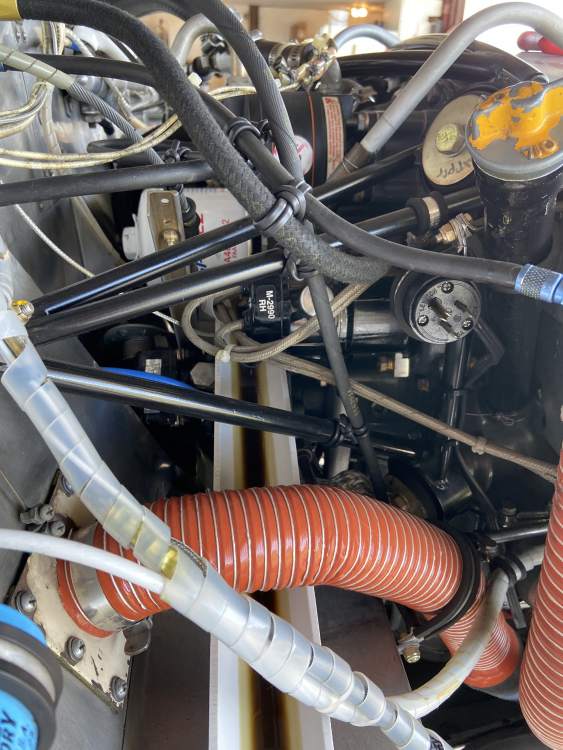

MikeOH Posted September 19, 2020 Author Report Posted September 19, 2020 On 9/19/2020 at 8:29 PM, Ragsf15e said: The V shaped metal piece under the filter and out to your bucket is the key. Expand Yuup! That was the missing element. I should have made a "How do I NOT make a MESS" post before embarking on this adventure! Quote

Austintatious Posted September 21, 2020 Report Posted September 21, 2020 On 9/19/2020 at 3:58 AM, MikeOH said: Ok, so I've owned my Mooney for three years but I have never changed the oil myself. The CB in me was NOT happy with this situation so, I thought, time to DIY! How hard could it be? Draining the oil was a piece of cake thanks to the quick drain some considerate PO installed! I literally did not spill a drop...ANYWHERE! Now, we get to the oil filter...clipped the safety wire at the filter, no problem. Stuffed a bunch of rags under the filter and unscrewed the filter...OMG! Oil down the back of the engine, down the shock discs, down the nose gear, onto the tire, puddle on the ground! SHEEESH!!! Cleaned up best I could, but lots of places my arm just couldn't get to. What did I do wrong??? More whining: What was the designer thinking putting the safety wire tang at the BOTTOM of the filter adapter??? Good grief, why wouldn't the damn thing be at the TOP where you can see and easily thread the safety wire through? Must have taken me 15 minutes to blindly get the damn wire through the tang by feel. Part of the problem is that there was another safety wire going through the same tang. Does two wires through one tang sound right? I've got better than 2 hours in the project and still need to do the run-up to check for leaks and put all the cowling back on, then cut open the old filter! I may just pay the shop the next time! Expand What I do is take a pointy object like a screwdriver and punch a hole into the oil filter as soon as possible... Then while I am letting the oil drain and doing other stuff it allows time for the filter to drain. If you can, let it sit overnight and there wont be a drop left in the filter. As far as the safety wire goes, I dont attach it to the provided point. I make a turn around the base of a fitting on the rear of the engine that is in a good location and lets the wire do its job properly. Wire comes off the oil filter tabs completely tangent to the secure point. It shouldn't take you 2 hours. at least not actually doing any work. I bet I do 30 min of work total, the rest is waiting for oil to move OUT and back in while I pour it. Sure would be nice if they sold w100 in 6 quart jugs! Quote
Vance Harral Posted September 21, 2020 Report Posted September 21, 2020 Everyone in this thread who tells you they can consistently change their oil without spilling a drop is a liar. We've been doing our own oil changes 2-3x year for the last 14 years. I have all the contraptions for dealing with the filter: the v-shaped piece of angle iron, the diagonally cut oil bottle, the rags, the bags, all of it. I've tried all the gimmicks, too: waiting two days after draining the oil to pull the filter, punching a hole in the filter, etc. And with dozens of oil change iterations under my belt I've finally reached the point where I only make a gargantuan mess pulling the filter every 2nd or 3rd time. It's just the way it is. Expect and plan for a mess. You won't feel disappointed or rushed when it happens, and you'll feel great on those occasions when it doesn't. 2 1 1 Quote
Vance Harral Posted September 21, 2020 Report Posted September 21, 2020 On 9/21/2020 at 3:56 PM, Austintatious said: What I do is take a pointy object like a screwdriver and punch a hole into the oil filter as soon as possible... Then while I am letting the oil drain and doing other stuff it allows time for the filter to drain. If you can, let it sit overnight and there wont be a drop left in the filter. Expand I keep hearing about this trick, and the claims there "won't be a drop left in the filter". But it just doesn't make any sense. Look at the picture of a Champion CH48110-1 filter that goes on a Lycoming IO-360, attached below. The filter spins on to the engine in a horizontal orientation, like the image on the right. There's about a half inch of distance between the filter case and the lowest hole in the filter. No matter how many holes you punch in the filter or how many days you wait for it to drain, there's still going to be several tablespoons of oil in the filter when you remove it. As you rotate the filter to unscrew it, that oil tends to ooze out the holes. Certainly if you rotate the filter very slowly, and/or if you're lucky enough to have a slight rearward cant in the mount, not much (or any) will spill out. But claims that you can completely drain the filter by simply waiting long enough are at odds with gravity. Quote
MinneMooney Posted September 21, 2020 Report Posted September 21, 2020 Splitting a 1.5” X 3’ PVC pipe works perfectly. I can insert it far enough to be completely under the filter to catch the stream of oil once I loosen it a few turns. It angles down at a reasonable angle to convey the old oil at a decent speed. I loosen the filter and let it drain overnight. Come back the next day and remove the old filter without spilling a drop. Anything larger would not fit into the tight space behind the engine. 3 Quote

Austintatious Posted September 21, 2020 Report Posted September 21, 2020 On 9/21/2020 at 5:00 PM, Vance Harral said: I keep hearing about this trick, and the claims there "won't be a drop left in the filter". But it just doesn't make any sense. Look at the picture of a Champion CH48110-1 filter that goes on a Lycoming IO-360, attached below. The filter spins on to the engine in a horizontal orientation, like the image on the right. There's about a half inch of distance between the filter case and the lowest hole in the filter. No matter how many holes you punch in the filter or how many days you wait for it to drain, there's still going to be several tablespoons of oil in the filter when you remove it. As you rotate the filter to unscrew it, that oil tends to ooze out the holes. Certainly if you rotate the filter very slowly, and/or if you're lucky enough to have a slight rearward cant in the mount, not much (or any) will spill out. But claims that you can completely drain the filter by simply waiting long enough are at odds with gravity. Expand You may be correct... My filter stands vertically with the threaded tube pointing down. Quote
MikeOH Posted September 21, 2020 Author Report Posted September 21, 2020 On 9/21/2020 at 11:13 PM, Austintatious said: You may be correct... My filter stands vertically with the threaded tube pointing down. Expand Well, wouldn't THAT be nice Quote
Austintatious Posted September 21, 2020 Report Posted September 21, 2020 On 9/21/2020 at 4:51 PM, Vance Harral said: Everyone in this thread who tells you they can consistently change their oil without spilling a drop is a liar. We've been doing our own oil changes 2-3x year for the last 14 years. I have all the contraptions for dealing with the filter: the v-shaped piece of angle iron, the diagonally cut oil bottle, the rags, the bags, all of it. I've tried all the gimmicks, too: waiting two days after draining the oil to pull the filter, punching a hole in the filter, etc. And with dozens of oil change iterations under my belt I've finally reached the point where I only make a gargantuan mess pulling the filter every 2nd or 3rd time. It's just the way it is. Expect and plan for a mess. You won't feel disappointed or rushed when it happens, and you'll feel great on those occasions when it doesn't. Expand IDK what to tell you. Maybe my plane is just easier. If I let it sit a day or so after being hot and punching a hole in the filter, I don't spill anything because there is nothing to spill. If I poke the hole and only wait the time it takes to fully drain the engine then I stuff some wads of paper towels down below the filter and it will catch most of it. Quote
Nippernaper Posted September 21, 2020 Report Posted September 21, 2020 I think I saw a service bulletin, maybe from Continental, trying to get folks to stop punching holes in oil filters. In any event, I've had great success with the form-a-funnel. The pvc pipe couldn't get under where the drips were coming from on the J.Sent from my iPhone using Tapatalk Quote
Vance Harral Posted September 22, 2020 Report Posted September 22, 2020 On 9/21/2020 at 11:17 PM, Austintatious said: IDK what to tell you. Maybe my plane is just easier. If I let it sit a day or so after being hot and punching a hole in the filter, I don't spill anything because there is nothing to spill. If I poke the hole and only wait the time it takes to fully drain the engine then I stuff some wads of paper towels down below the filter and it will catch most of it. Expand If your filter has a vertical orientation when installed, it's ten-thousand-percent easier! Quote
