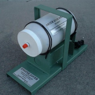

I have a TCM engine, but still the same concerns.  Just about every flight that I return to my hanger, I open the oil cap and let the crankcase breathe out the steam while I push-back and clean the plane up. I do not do this when remote. I am unsure it does anything but it cannot hurt as long as I cover it back up before leaving for the day.  I also acquiredan "Engine Saver" on the cheap that de-humidifies the engine thru the breather tube.  I have used it and it seems to do what it was designed to do: pump low humid air into the engine to "dry" the engine from normal condensation generated from combustion.  Again... I figure it cannot hurt.

We bought a Tanis engine dehydrator and then put orange and white beads in it because the blue ones are toxic. Cobalt.
Then I modified it with the humidity sensor and switch. Because the stock configuration it runs all the time and depletes the beads quickly.
Are you sure about that?
From the instructions
When the Engine Saver is first turned on, it is designed to run continuously for 1 hr. This will flush all of the moist gas out of the crankcase as the engine cools, and establish a protective shield of dry air inside the crankcase and the cylinders. After the initial hour has passed, the systemgoes into the monitoring mode
