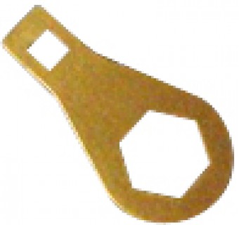

EricJ Posted August 17, 2018 Report Posted August 17, 2018 4 hours ago, RLCarter said: If you don't feel like doing the math, clocking the crows foot 90° will get you close, but they are wrong. And the point of using the crows foot is that access is difficult, so you can't always set torque with it turned like that. I don't think I can get mine on that way. Or you can just realize that the torque spec of 16-18 (or 16-20 depending on what you're looking at) has a fair amount of tolerance already. If you're worried about over-torquing the filter due to the addition of the crow's foot, the torque spec has more slop than the small addition of the crows foot to the lever arm. Set the torque wrench toward the lower end of the spec tolerance, or, if you're really anal, calculate the reduced torque spec for the length extension and use that instead. I don't think there's room for a socket of any kind on the A3B6D in my J, so I've been using the crow's foot. Plus I use a Harbor Freight torque wrench, so it just gets it reasonably close without going grossly over or under. I don't think this is one of those things that really needs that much precision. 1
Bob_Belville Posted August 17, 2018 Report Posted August 17, 2018 8 hours ago, xcrmckenna said: It’s expensive but works great to take the filter off and on.http://m.aircraftspruce.com/catalog/topages/AA472.php?clickkey=655613 Sent from my iPhone using Tapatalk If I were doing more than 3 oil changes a year I think I'd buy that one as well. It's a single purpose tool preset at 17 ft lbs. 1

Hank Posted August 17, 2018 Report Posted August 17, 2018 5 hours ago, RobertGary1 said: You guys make this far more complicated than it needs to be.. -Robert This is what I have used for eleven years. Fits fine, works great!

Bob_Belville Posted August 17, 2018 Report Posted August 17, 2018 10 minutes ago, Hank said: This is what I have used for eleven years. Fits fine, works great! Youse guys ever have your "built in torque gage" double checked with a boring old torque wrench? Do spark plugs get more precise tightening?

Hank Posted August 17, 2018 Report Posted August 17, 2018 6 minutes ago, Bob_Belville said: Youse guys ever have your "built in torque gage" double checked with a boring old torque wrench? Do spark plugs get more precise tightening? I use a torque wrench on my plugs, but there's no socket space between the oil filter and the firewall. There's barely room to unscrew the filter.

Bob_Belville Posted August 17, 2018 Report Posted August 17, 2018 20 minutes ago, Hank said: I use a torque wrench on my plugs, but there's no socket space between the oil filter and the firewall. There's barely room to unscrew the filter. The ~$15 oil filter torque wrench I linked above should work in your close quarters.
Andy95W Posted August 17, 2018 Report Posted August 17, 2018 5 hours ago, Bryan said: Yes, have one of those, too, for removing the filter but what about torquing it back on? Spin the filter on until the gasket just barely makes contact with the filter mount. Tighten a little more than 3/4 of a turn. Safety wire. I will neither confirm nor deny that I use this technique in lieu of a torque wrench. 3

Jsavage3 Posted August 18, 2018 Report Posted August 18, 2018 11 hours ago, xcrmckenna said: It’s expensive but works great to take the filter off and on.http://m.aircraftspruce.com/catalog/topages/AA472.php?clickkey=655613 Yes, works great! It was a “wife, buy this for me for Christmas” present. She smiles every time she sees me using it... +1 for Tempest 2

jetdriven Posted August 18, 2018 Report Posted August 18, 2018 (edited) 18 hours ago, RobertGary1 said: You guys make this far more complicated than it needs to be.. -Robert Yes gasket contact plus 3/4 turn gets it every time. You’re looking for a rubber gasket crush. Depending on a few factors, 18ftlb torque may not be close. Its the same thing with the crush gasket on the oil sump screen. Edited August 18, 2018 by jetdriven 1
Awful_Charlie Posted August 18, 2018 Report Posted August 18, 2018 12 hours ago, Andy95W said: Spin the filter on until the gasket just barely makes contact with the filter mount. Tighten a little more than 3/4 of a turn. Safety wire. I will neither confirm nor deny that I use this technique in lieu of a torque wrench. My original mechanic had me screw on firmly by hand, and then 2 flats (1/3 turn) That's worked for me on multiple aircraft over 20 years and I guess 50+ filters - never a leak yet! (and more importantly, not a problem to get them off again!) 2

Mooney in Oz Posted August 19, 2018 Report Posted August 19, 2018 Still need to be careful. From one of the reviews on the Spruce website: “Made in China equals sloppy calibtation for torque. It was not even close to the correct torque for proper tightness for the filter. Resulting in the filter being excessively tight. Works fine for removing filter but not installation.”
Bryan Posted August 19, 2018 Report Posted August 19, 2018 I sent mine in to Tempest (US) for recalibration, and had it back within the week with a calibration paper signed by Greg: great customer service. 1
EricJ Posted August 19, 2018 Report Posted August 19, 2018 2 hours ago, Mooney in Oz said: Still need to be careful. From one of the reviews on the Spruce website: “Made in China equals sloppy calibtation for torque. It was not even close to the correct torque for proper tightness for the filter. Resulting in the filter being excessively tight. Works fine for removing filter but not installation.” Was this person using the torque wrench to remove the filter? Might have something to do with why it's not holding calibration. 3
Mooney in Oz Posted August 19, 2018 Report Posted August 19, 2018 7 hours ago, EricJ said: Was this person using the torque wrench to remove the filter? Good point, but we'll never know. There were a couple of other gripes on there due to to the device being made in China.
