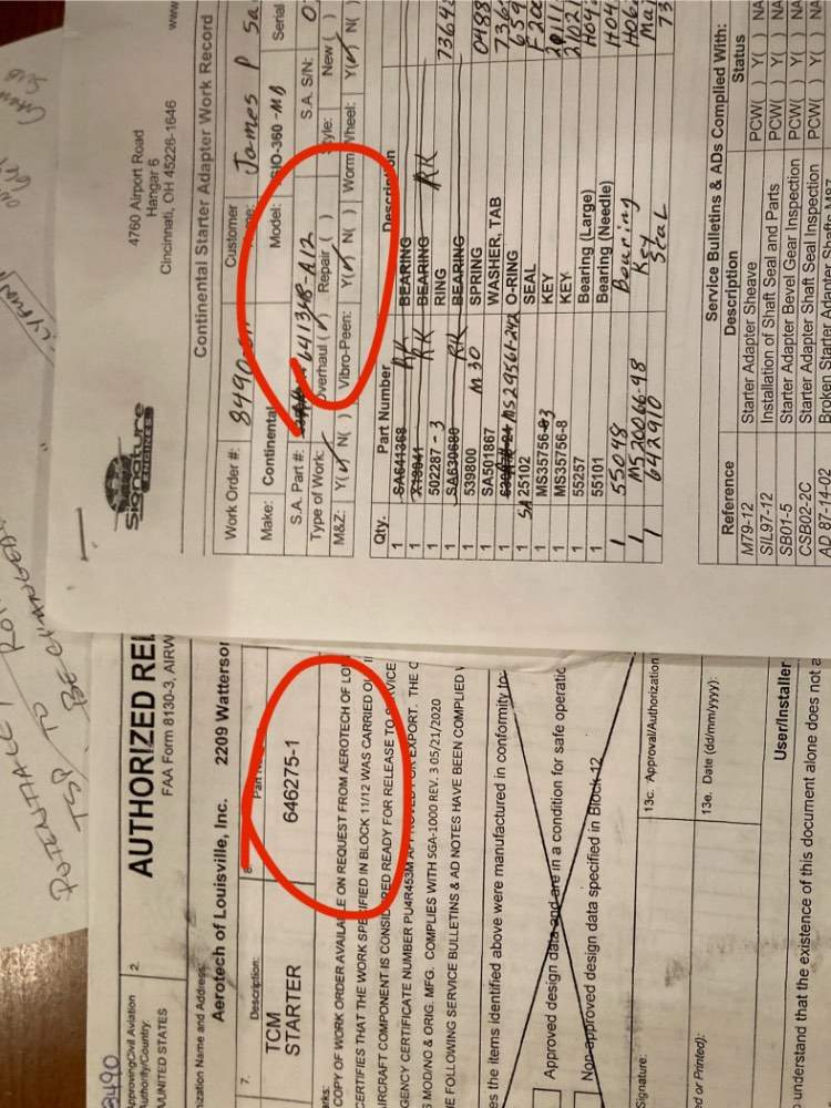

Ragsf15e Posted May 24, 2025 Author Report Posted May 24, 2025 1 hour ago, Schllc said: I have adjusted my habits to where when something like this happens, rather than send in for an overhaul, I buy a new one, and send the old for overhaul for a spare. done it with quite a few parts. Starter, turbo, magneto, fuel pump etc. This is not practical to do with everything obviously, but nothing upsets me as much as owning an airplane that I cannot use! And having a few extras of items that are wear susceptible. I have had one trip in eight years that was cancelled like yours, although I had taken off when the magneto failed and had to turn around and land, then cancel. I would do that with the starter… the adapter fits your other category though. Ouch.
1980Mooney Posted May 24, 2025 Report Posted May 24, 2025 (edited) 15 minutes ago, Ragsf15e said: Can we tell from the part number exactly what starter it is? The 8130 from last overhaul says “”TCM Starter”. Here’s the ssn of the adapter too… is there any better adapter to use or just get this one repaired/exchanged by a good shop? Starter - 646275-1 Adapter - 641348-A12 Alt Application Data That is the recommended Hartzell starter. See pdf above. New Starters From Hartzell Engine Tech | Aircraft Spruce ® Edited May 24, 2025 by 1980Mooney 1
