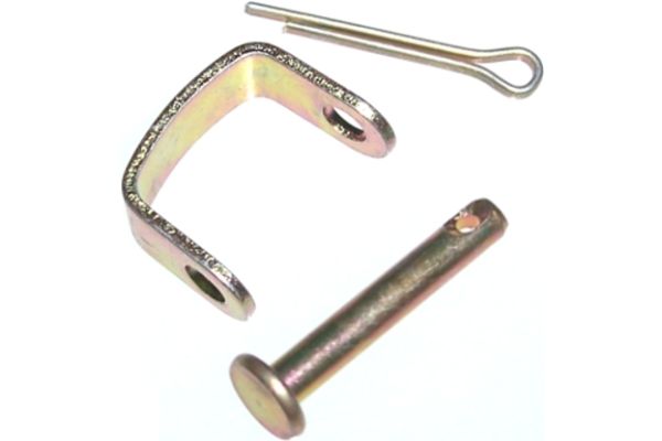

EricJ Posted September 20, 2022 Report Posted September 20, 2022 I have the equivalent of the Cessna stop pins, like this: only with safety pins instead of cotter pins, so they're easy to pop in and out. Makes removing/replacing the seats a breeze. 1
201Steve Posted September 20, 2022 Report Posted September 20, 2022 30 minutes ago, EricJ said: I have the equivalent of the Cessna stop pins, like this: only with safety pins instead of cotter pins, so they're easy to pop in and out. Makes removing/replacing the seats a breeze. What’s the point of the bracket? Also where do u get these

EricJ Posted September 20, 2022 Report Posted September 20, 2022 12 hours ago, 201Steve said: What’s the point of the bracket? Also where do u get these The bracket goes over the seat rail and stops the seat. A web search on "Cessna seat stop" brings up a few options, but I think they come from McFarlane: https://www.mcfarlaneaviation.com/products/product/SEAT%20STOP%20KIT%201/ The safety pin is just the usual that you can get at just about any hardware store or in the aviation aisle at Lowes or Home Despot. You can get the clevis pins there, too, and the "bracket" is just a little piece of sheet metal that can be fabricated pretty easily. If somebody wanted to put their own together it wouldn't be very difficult.

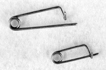

Andy95W Posted September 20, 2022 Report Posted September 20, 2022 Wow, y’all like to spend money. These are about 50 cents each at your local hardware store. You need 4. 3 1 1

A64Pilot Posted September 21, 2022 Report Posted September 21, 2022 14 hours ago, Andy95W said: Wow, y’all like to spend money. These are about 50 cents each at your local hardware store. You need 4. I have them in my airplane, occasionally they come out. You figure that out when the seat goes too far and you have to put it back in the tracks, no big deal, but annoying as everyone has to get out etc. I’ve taken to pushing them in all the way and that has seemed to help. I do like the quick release feature though and why I’m going to give the quick release pins a go, too bad the one with the button isn’t available. I also draw a line with a sharpie on the seat track prior to removing them, makes finding the hole a lot easier on reinstallation.
