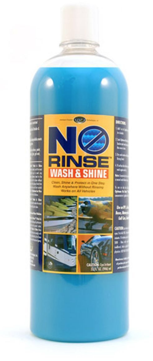

Ross Taylor Posted April 16, 2020 Report Posted April 16, 2020 32 minutes ago, PJClark said: My seats were just done last summer. I've touched them up twice now using the recommended 1:256 (1 oz ONR to 2 gal water) solution of Optimum No Rinse. Magical. This the magical stuff of which you speak? Quote
PJClark Posted April 16, 2020 Report Posted April 16, 2020 That's it. an ounce of that in 2 gal of water in a 5 gal bucket--you wash and dry your airplane in the hangar--no hose. Shines like crazy. Dampen one of your microfiber towels with the solution and wipe down the seats...totally clean, no suds, no residue, no rinsing. Effing magic. 1 1 Quote

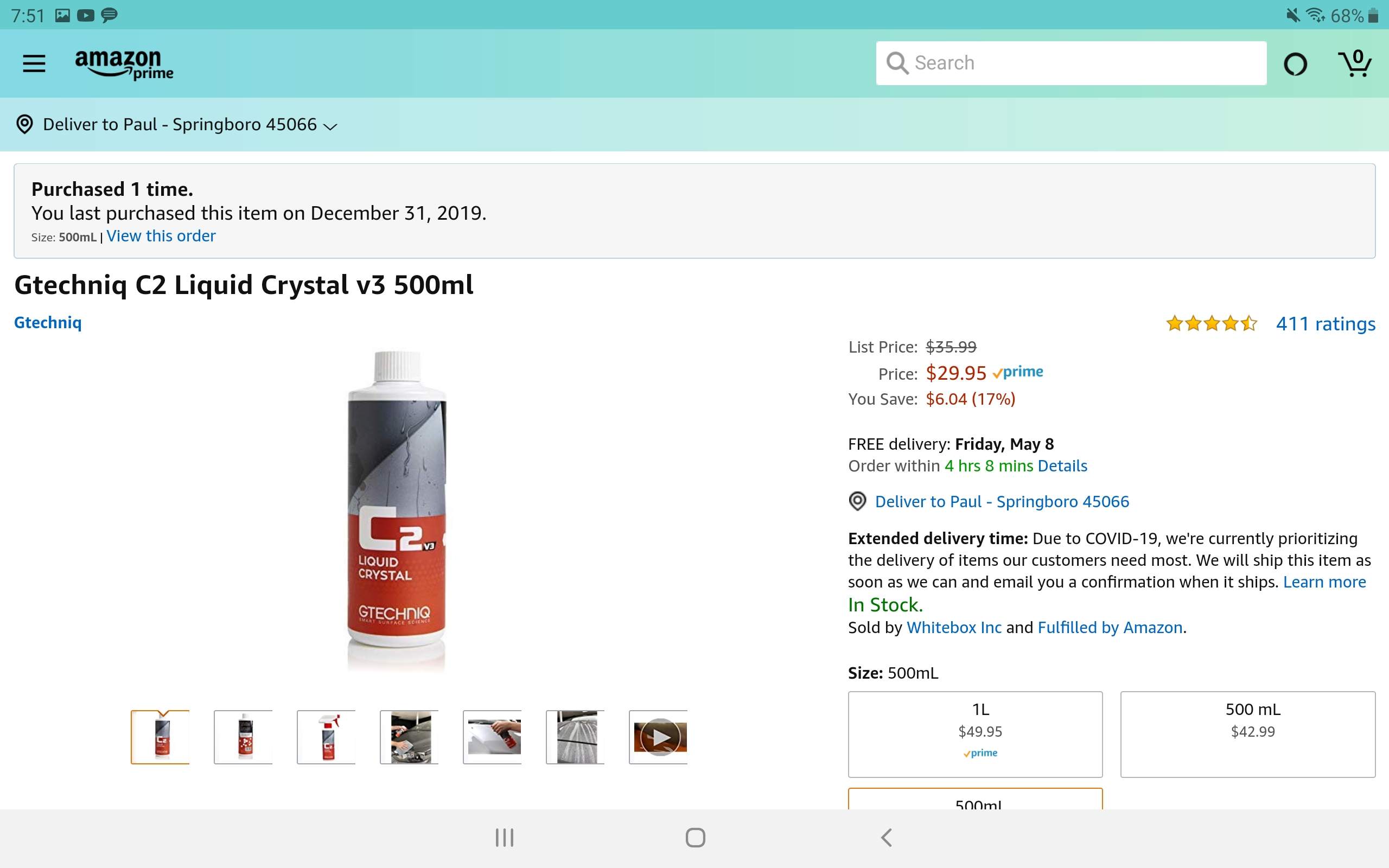

PJClark Posted April 16, 2020 Report Posted April 16, 2020 here are the other things I use: GTechniq W5--1-5 in a spray bottle to pre-clean your belly..totally degreases and removes exhaust...follow up with a wash with ONR solution ONR Big Red Sponge--ideal for washing with the ONR solution in that bucket--find the big red sponge video on YouTube Microfiber towels--this bundle is economical, thick, and soft--no scratching. Gtechniq C2V3--DIY ceramic coating. apply right after wash with ONR. 6-12 months ceramic coating protection...slippery, makes next cleanup with ONR very easy, very fast! 1 1 Quote

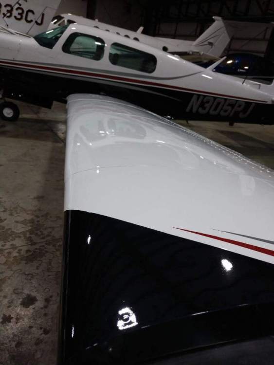

carusoam Posted April 20, 2020 Report Posted April 20, 2020 The depth of shine is amazing... The no step sign appears to float above the surface... -a- 1 Quote
PJClark Posted April 20, 2020 Report Posted April 20, 2020 It's my second go with the C2V3. They call it "stacking," it's all car detailing stuff. Didn't get that big an impact the first time but I'm sure diggin' this! Quote

Htmlkid Posted May 7, 2020 Author Report Posted May 7, 2020 On 4/19/2020 at 8:10 PM, carusoam said: What did you use to get such a nice shine? Quote

gsxrpilot Posted May 7, 2020 Report Posted May 7, 2020 On 4/19/2020 at 6:08 PM, PJClark said: Cleaned and shined everything! That is a very good looking Rocket! Maybe the best I've seen anywhere. 1 Quote
