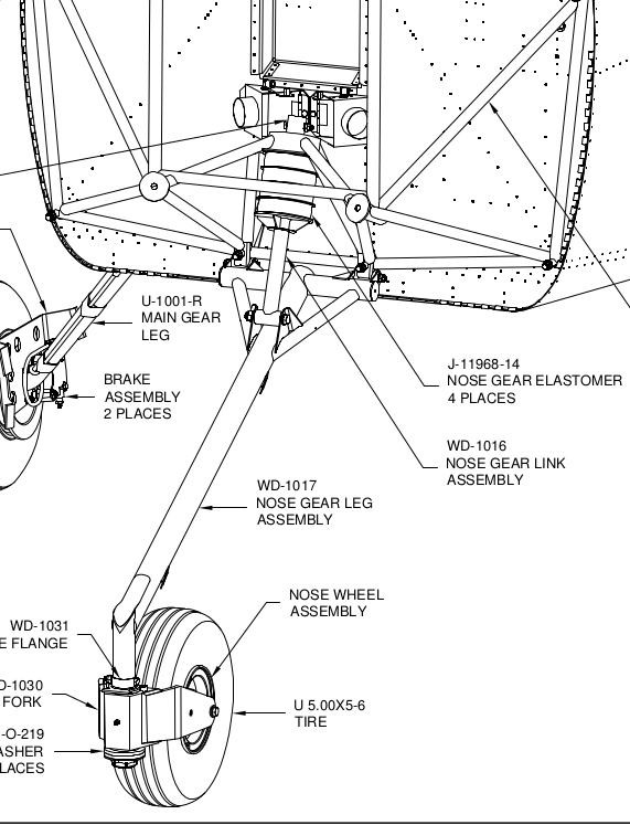

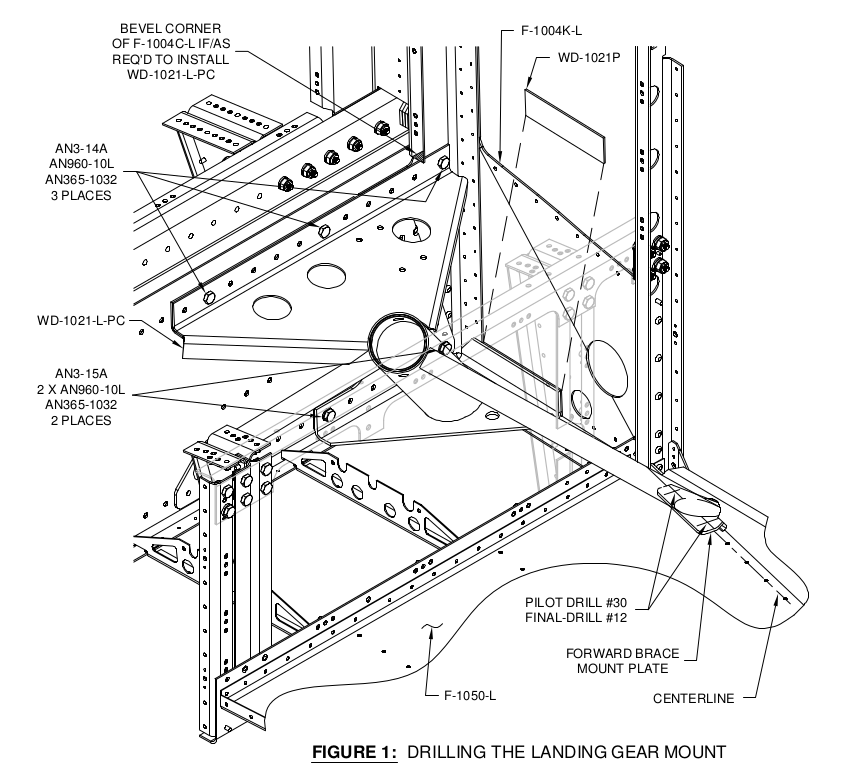

1001001 Posted May 21, 2020 Report Posted May 21, 2020 (edited) On 3/24/2020 at 11:40 PM, Blue on Top said: Anybody willing to try this with me? It would NOT be a "C"/"D" difference. I know the obstacles and how to certify! There has to be a geared up airplane out there somewhere or one left to corrode on a ramp. How do I get on the list of insurance companies that sell these "totaled" airplanes? Seriously, Ron PS. The benefits could be huge: half insurance premiums, lower annual costs, higher useful load, etc. If you're serious about this, have a look at the landing gear on an RV-10. Designed for 2700 lb gross weight, parts can be bought in a kit (I have them sitting right here), and the nose gear uses a Mooney-like puck arrangement as a shock absorber. Having a close look at the parts might give clues as to how they could be scabbed onto a different airframe. The weight savings would be significant. The main issue I can see is that the RV-10 sits much higher off the ground than the Mooney, partly because the steel main legs need to be long enough to be able to deflect enough to absorb landing forces. The RV landing forces are carried through some stout brackets to the center section of the spar carry through, whereas the Mooney forces are basically straight up to the spar out in the wing. It would be a major effort to convert, I think. The nose gear would be difficult, as the RV-10 nose gear attach is integral to the engine mount, and wouldn't have much to attach to up in the Mooney's nose gear well. Edited May 21, 2020 by 1001001 Quote
Blue on Top Posted June 1, 2020 Report Posted June 1, 2020 @1001001 The RV gear is a good idea, but the load paths are completely different and the regulations are different, too …. which equates to HUGE certification efforts and expenses. Although Don Maxwell may not agree with me , the Mooney gear is a good gear. And fixing it in place will eliminate almost all the issues (and lots of weight) … not the donuts, though . Quote
