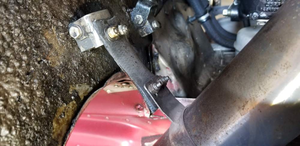

What, you mean this?
It was cut from the sidewall of my old nose tire . . . By my IA, at annual. Looked just like the broken one it replaced.

3 hours ago, Cyril Gibb said:
Is that a nylock nut forward of the firewall? Or is that question too anal for the MooneySpace crowd?
When the fire starts, the nut will melt and vibrate loose, releasing 1/2 the hanger strap, dropping the tail pipe into the inferno.
It isn't right, but I think he is going to live to fly another day!
Never paid it any attention. She's been annualed by 3 different IAs in the 11 years I've owned her, and even the one who cut the new strap from my old tire and helped replace it after he pointed out that it was broken didn't say anything . . . What do they say about a new set of eyes?
I think he'd have much bigger issues in fire then broken strap. :D
