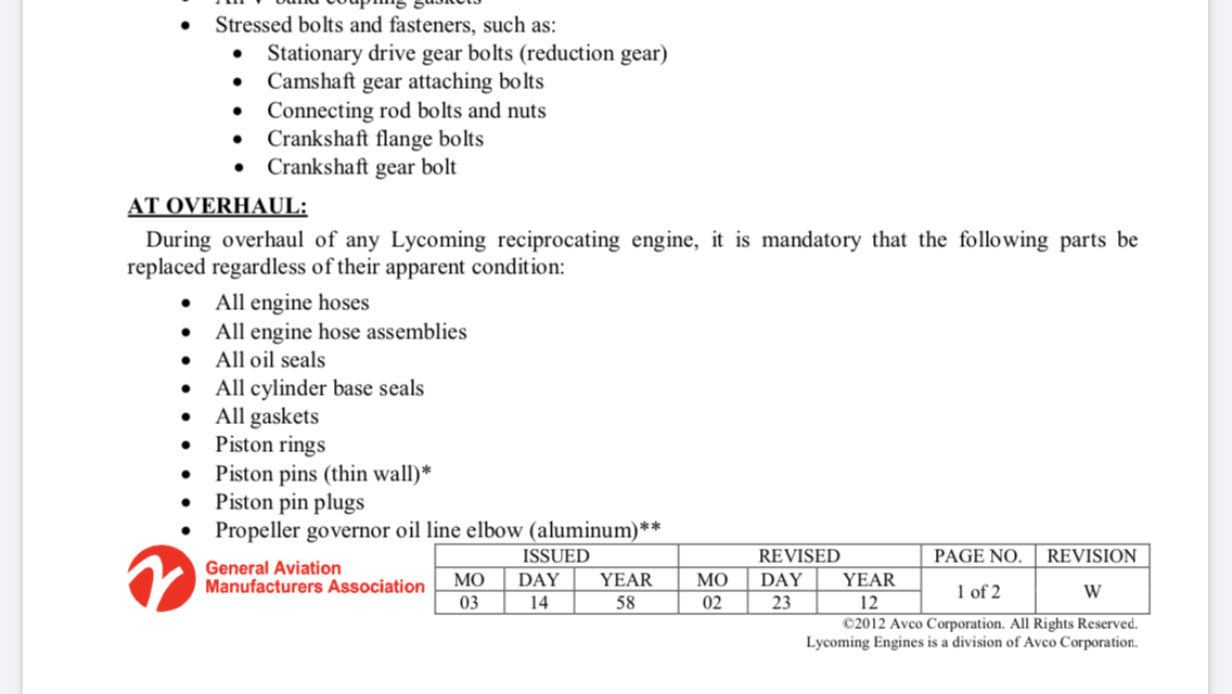

Tcraft938 Posted August 21, 2019 Report Posted August 21, 2019 Your response intrigued me regarding if the engine is run/broken in on the airplane and whether that constitutes a break-in or repair. I picked up my overhauled to new limits engine from the overhaul shop. I have an engine logbook entry that it was run in an approved test cell for 3.4 hrs. There is documentation that explains the test cell and dates of calibration/approval of the cell. Also in the book is a page of data of the various instrument parameters during the run which I found interesting and a bit above my knowledge base. Three pages of "in the airplane break-in instructions". So based on your info and others, I guess I'm glad I went the route I did rather than the guy that wanted me to order parts and he would "slap it together for ya". In the end the difference in price was not drastic and much better warranty on the workmanship.
jetdriven Posted August 21, 2019 Report Posted August 21, 2019 8 hours ago, cliffy said: Good answers above- How many hours on the engine? How many cylinder overhauls on them? How long since last overhaul? Is the crack with in any limits set by Lycoming to continue to run? What are your plans for the future? Keep the airplane forever? Sell in a couple of years? This repair has consequences each way. All these need to be answered before a good path can be found Cases are matched to each other, they are "line bored" for the cam bearings and the crank bearings. Can't just toss a different case half in the mix. Now your decision is to either go "repair" or "overhaul" If you have less than 1,000 hrs on the overhaul and its been less than 5 or 6 years since it was overhauled you can just repair it. Get a good case, measure all the pieces that move and if they meet ""serviceable" limits, reassemble and run. This is done all the time for prop strikes. Now if you are past half life on overhaul then you might be money ahead to do a full overhaul. Usually "overhaul" brings internal limits on fit to "new engine" standards AND it requires a complete run in (can be done on the airplane) following the factory program USING CALIBRATED INSTRUMENTS. This is a big point missed by many. If your engine gauges in the airplane haven't been out and their accuracy checked (calibrated) with in the last year, you can't run the engine after overhaul in the airplane and call it an "overhaul". Its still only a repair, time continuing, Its a glitch in the way the Feds view the definitions on what constitutes an overhaul and Lycoming specifies "calibrated instruments" for an 'Overhaul Run In Procedure. Overhaul shop test cell gauges are (should be) calibrated every year. Did you know that "technically" even your A&Ps tools are required to be "in calibration" to use them? Say, his torque wrench :-) The engine has the same work done to it but the run in is classified different. Its always a crap shoot when the engine is opened up. You can get lucky or shoot craps (snake eyes) and find more work but if you find more work inside, just consider yourself lucky that you found it now and not at 10,000' My factory engine sticker said overhauled even though it wasn’t yet installed with the “new hoses and calibrated instruments”. I’m not sure they can enforce a SB240a and rescind the overhaul log entry. Also any new case From Lycoming is going to be made for roller lifters. you’ll need roller lifters and a roller cam that’s about another four grand.
N201MKTurbo Posted August 21, 2019 Report Posted August 21, 2019 It depends if you have a narrow deck or a wide deck case. If you have a narrow deck case, you better hope Divco can weld it because there are no new or used cases anywhere. You will have to upgrade to a wide deck case which means new cylinders. You might as well look for a used engine. 1
cliffy Posted August 22, 2019 Report Posted August 22, 2019 3 hours ago, jetdriven said: My factory engine sticker said overhauled even though it wasn’t yet installed with the “new hoses and calibrated instruments”. I’m not sure they can enforce a SB240a and rescind the overhaul log entry. Also any new case From Lycoming is going to be made for roller lifters. you’ll need roller lifters and a roller cam that’s about another four grand. Did your new engine come with notations that it was already run in in the test cell? My point being that the initial "run in" from the bench assembly needs to be done with calibrated gauges not that the engine has to be "installed" with calibrated gauges. The FAA has on a couple of instances with me (in airport discussions) made it plain that the sign off "overhauled" includes the initial run in period with calibrated gauges as the Lycoming manual states. Whether its in the airplane or in a test cell doesn't matter. Also (and I won't have time to look it up right now) I think you will find reference to "overhaul" and what it means in the regs
cliffy Posted August 22, 2019 Report Posted August 22, 2019 (edited) 10 hours ago, Tcraft938 said: Three pages of "in the airplane break-in instructions". Once the engine is initially run with calibrated gauges to be sure all is well, the rings seat, oil consumption checked and no leaks are apparent, after that it's just getting some time on it checking that stays "in limits" and you have no infant mortality. In the Lycoming Overhaul Manual the following is stated for the run in period if it is to be done in the airplane ( they recommend a test cell but will allow the airplane to be used IF)- 1) The proper Test Club propeller is used. NOT a flight propeller. 2) A cooling shroud equivalent to a test cell cooling shroud shall be used. 3) The airframe gauges may NOT be used. ALL necessary calibrated gauges shall be installed independent of the airframe The manual run in time accounts for the first 2hr and 15 mins of the engine time if done by the book. The last hour of the run is at normal rated RPM (max allowable). This is for oil consumption checking. It must fall under about 3/4 of a qt per hour. Now in reality many do it in the airplane with the airplane propeller. But as noted, if push comes to shove, the Feds can (and have) hammered A&Ps for not following the run in in the book. At the very least one should follow the run in procedure as to hours and RPMS on the test. One could make a case of using the airplane gauges if they were calibrated recently I think. And it still comes down to- if you didn't use calibrated gauges you can't technically call it an "overhaul" because you didn't follow the book by Lycoming. Kind of makes a test cell look real good don't it? Now if one is the kind of person that picks and chooses what rules they will follow then have at it and do it your way. Chances are you'll never get caught (until there is an investigation, then all bets are off). Now, remember who is legally responsible for the maintenance on the airplane- YOU the owner! There was a notable case a couple decades ago where the mech told the owner to just go up and fly it like you stole it and there was an accident. The FAA came back and violated the A&P by saying "What makes you think you know more about how to break in an engine than the manufacturer"? Thoughts to ponder Shields up Edited August 22, 2019 by cliffy
jetdriven Posted August 22, 2019 Report Posted August 22, 2019 49 minutes ago, cliffy said: Did your new engine come with notations that it was already run in in the test cell? My point being that the initial "run in" from the bench assembly needs to be done with calibrated gauges not that the engine has to be "installed" with calibrated gauges. The FAA has on a couple of instances with me (in airport discussions) made it plain that the sign off "overhauled" includes the initial run in period with calibrated gauges as the Lycoming manual states. Whether its in the airplane or in a test cell doesn't matter. Also (and I won't have time to look it up right now) I think you will find reference to "overhaul" and what it means in the regs Yes it was ran in a test cell at Lycoming. That same SB240a says that the engine must be installed with new hoses. However those are an airframe component. Again, I’m not sure how a fed can use an SB to say an engine wasn’t considered overhauled because they re-used the hoses that may only be a year old.
jetdriven Posted August 22, 2019 Report Posted August 22, 2019 (edited) 13 minutes ago, cliffy said: Once the engine is initially run with calibrated gauges to be sure all is well, the rings seat, oil consumption checked and no leaks are apparent, after that it's just getting some time on it checking that stays "in limits" and you have no infant mortality. In the Lycoming Overhaul Manual the following is stated for the run in period if it is to be done in the airplane ( they recommend a test cell but will allow the airplane to be used IF)- 1) The proper Test Club propeller is used. NOT a flight propeller. 2) A cooling shroud equivalent to a test cell cooling shroud shall be used. 3) The airframe gauges may NOT be used. ALL necessary calibrated gauges shall be installed independent of the airframe The manual run in time accounts for the first 2hr and 15 mins of the engine time if done by the book. The last hour of the run is at normal rated RPM (max allowable). This is for oil consumption checking. It must fall under about 3/4 of a qt per hour. Now in reality many do it in the airplane with the airplane propeller. But as noted, if push comes to shove, the Feds can (and have) hammered A&Ps for not following the run in in the book. At the very least one should follow the run in procedure as to hours and RPMS on the test. One could make a case of using the airplane gauges if they were calibrated recently I think. And it still comes down to- if you didn't use calibrated gauges you can't technically call it an "overhaul" because you didn't follow the book by Lycoming. Kind of makes a test cell look real good don't it? Now if one is the kind of person that picks and chooses what rules they will follow then have at it and do it your way. Chances are you'll never get caught (until there is an investigation, then all bets are off). Now, remember who is legally responsible for the maintenance on the airplane- YOU the owner! There was a notable case a couple decades ago where the mech told the owner to just go up and fly it like you stole it and there was an accident. The FAA came back and violated the A&P by saying "What makes you think you know more about how to break in an engine than the manufacturer"? Thoughts to ponder Shields up Lycoming SI 1427c specifically allows the full airframe baffling and a flight propeller. Edited August 22, 2019 by jetdriven
cliffy Posted August 22, 2019 Report Posted August 22, 2019 Seems they are at odds but I'll go with your post ok. 18 minutes ago, jetdriven said: Yes it was ran in a test cell at Lycoming. That same SB240a says that the engine must be installed with new hoses. However those are an airframe component. Again, I’m not sure how a fed can use an SB to say an engine wasn’t considered overhauled because they re-used the hoses that may only be a year old. Not saying that it can't be considered an overhaul as it was run in in a test cell with calibrated gauges. Overhaul done. In what and how its installed in is another matter. Hoses have nothing to do with the overhaul.
jetdriven Posted August 22, 2019 Report Posted August 22, 2019 9 minutes ago, cliffy said: Seems they are at odds but I'll go with your post ok. Not saying that it can't be considered an overhaul as it was run in in a test cell with calibrated gauges. Overhaul done. In what and how its installed in is another matter. Hoses have nothing to do with the overhaul. Lycoming SB 240W mandates that all engine hoses be changed at overhaul. Is that binding? Is SI 1427C binding?
Guest Posted August 22, 2019 Report Posted August 22, 2019 I believe that the reference to new hoses in SB240 refers to only those hoses supplied as part of the engine, not the airframe interface hoses. Clarence
