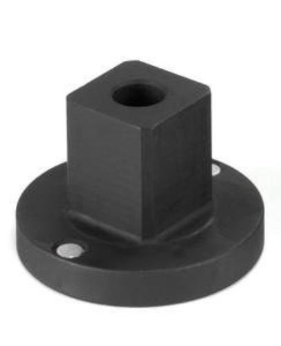

47U Posted October 7, 2016 Report Posted October 7, 2016 Rather than struggle with a 3/8" to 1/2" adapter, I scrounged up a scrap length of 1/2" OD square tube, which conveniently has a 3/8" ID. Cut off 1/2" or so length and dress up the edges with a file. It slides right over the 3/8" drive of the torque wrench and fits nicely inside the 1/2" square hole in the gear tool. Red paint is optional. It really does help with stability of the torque wrench. 2 Quote
DaV8or Posted October 7, 2016 Report Posted October 7, 2016 (edited) 52 minutes ago, 47U said: Rather than struggle with a 3/8" to 1/2" adapter, I scrounged up a scrap length of 1/2" OD square tube, which conveniently has a 3/8" ID. Cut off 1/2" or so length and dress up the edges with a file. It slides right over the 3/8" drive of the torque wrench and fits nicely inside the 1/2" square hole in the gear tool. Red paint is optional. It really does help with stability of the torque wrench. If you read my posts above, that's exactly what I did. It really helped. There is a little more to it. There was a lot of filing required on the inside of the tubing, but not difficult work. I used 1/2" square cold rolled .062 wall tubing. Also for those that don't want to be a CB, you can also buy this- It is a sleeve that slips over the 3/8" drive and has magnets to hold in place on the socket. $10 on Amazon. I had the tubing already and it got me closer on axis then this would. Edited October 7, 2016 by DaV8or 1 Quote
