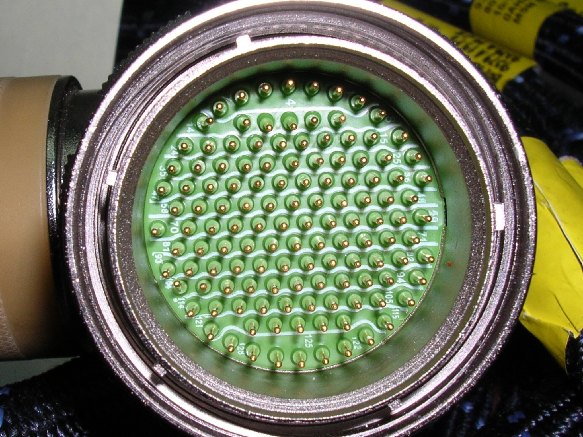

47U Posted December 16, 2020 Report Posted December 16, 2020 At the extreme end, can you spot the bent pins? Hint... there’s 5. Within reason, multiple-pin connectors can clean up a lot of mess behind the panel. At least it did in my case. Disclaimer, this connector is not in my C.
bob865 Posted December 16, 2020 Report Posted December 16, 2020 20 minutes ago, 47U said: At the extreme end, can you spot the bent pins? Hint... there’s 5. I think I found them. Pins 11, 12, 14, 103, 104. I see a bunch of others I would adjust before I tried to connect it again. Like 17, 31, 43, and 86 to name a few. What's your 4th? 1
47U Posted December 16, 2020 Report Posted December 16, 2020 Keen eye! 11, 12, 14, 19, and 104, according to the contractor’s sticky note. I agree with you, there were others that needed adjustment.

Yetti Posted December 17, 2020 Author Report Posted December 17, 2020 9 hours ago, 47U said: At the extreme end, can you spot the bent pins? Hint... there’s 5. Within reason, multiple-pin connectors can clean up a lot of mess behind the panel. At least it did in my case. Disclaimer, this connector is not in my C. 2 seconds to find the ones around the outer ring. I am no fun at the movies, I can see the missed edits and other things out of place. 1
carusoam Posted December 17, 2020 Report Posted December 17, 2020 Speaking of Eagle Eye awards... you guys are good! I found about two... Best regards, -a-
ArtVandelay Posted December 17, 2020 Report Posted December 17, 2020 2 seconds to find the ones around the outer ring. I am no fun at the movies, I can see the missed edits and other things out of place.Isn’t that the usual case, because they weren’t aligned, so the outer pins are first to make contact, and get bent?This could be prevented if they had longer sleeves to prevent misalignment.
Yetti Posted December 17, 2020 Author Report Posted December 17, 2020 4 hours ago, ArtVandelay said: Isn’t that the usual case, because they weren’t aligned, so the outer pins are first to make contact, and get bent? This could be prevented if they had longer sleeves to prevent misalignment. i would think it's a fail of the tech. Everyone knows Align and straight in and straight out on connectors. I would bet those were bent on removal because someone was not pulling straight out and let it twist. The cannon connectors on the Mooney are pretty good as they force straight in and straight out till the pins are not engaged. 1
EricJ Posted December 17, 2020 Report Posted December 17, 2020 Often pins get bent like that by mishandling when the connectors are apart. Most decent Canon/Mil connectors prevent pin damage during mating/disconnect.
