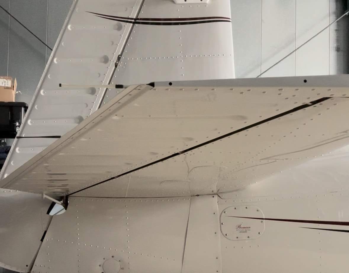

885EW Posted Tuesday at 07:48 PM Author Report Posted Tuesday at 07:48 PM Photo for reference at position where it sticks/binds. Quote

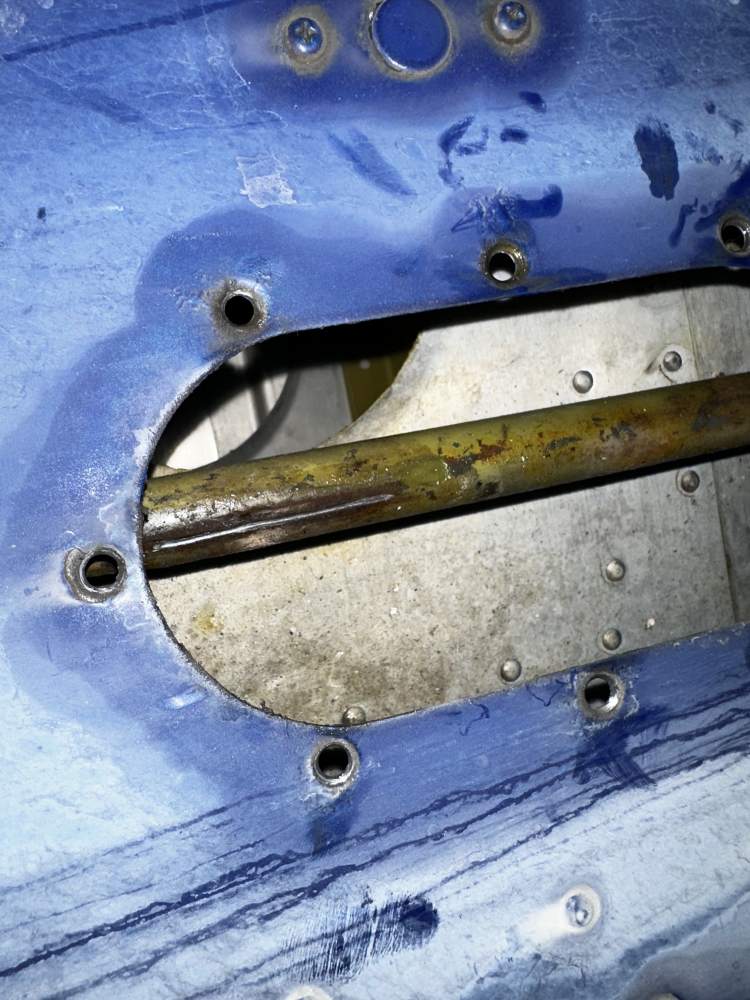

natdm Posted Thursday at 05:39 PM Report Posted Thursday at 05:39 PM Not sure if it applies here too but mine (M20K) would do this from time to time and I took off the inspection panels on the bottom of the body and realized one of the screws for the panels was too long and was wearing a mark in to one of the push-rods. I just keep the screw out and it works fine now (after IRAN the rod). Maybe check for that too? Quote
