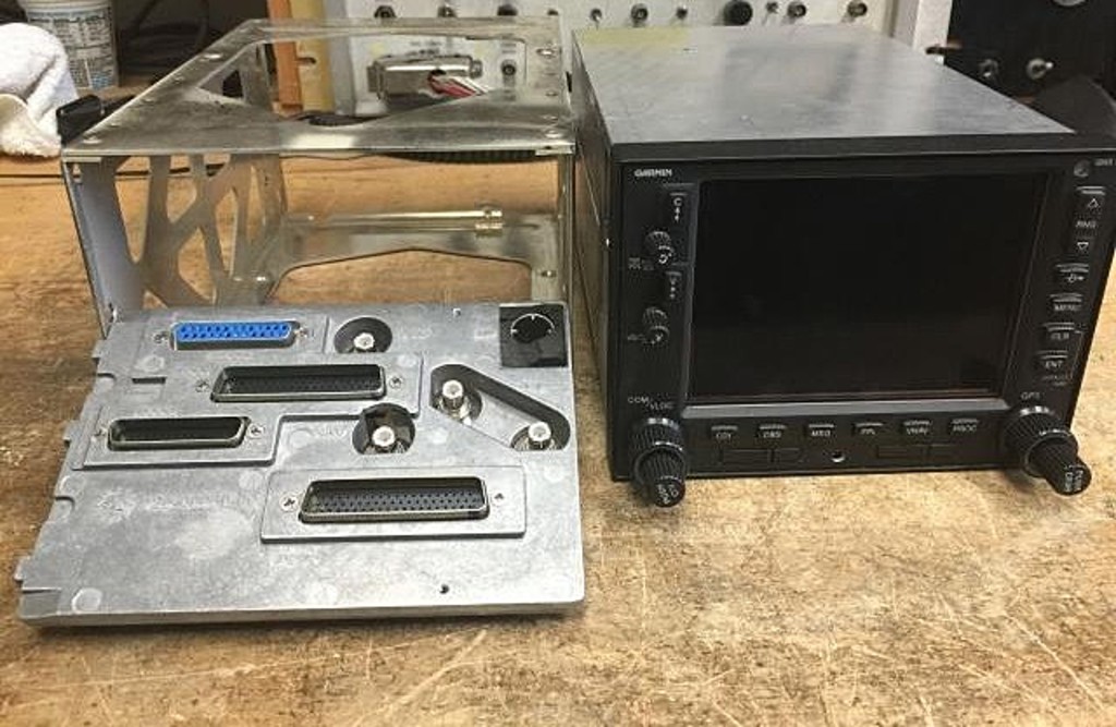

Austintatious Posted September 16, 2023 Author Report Posted September 16, 2023 On 9/15/2023 at 9:18 AM, JimB said: I'd love to see some pictures of the upside down connector. If you look at a back plate on 530W rack, there are cutouts for the connectors. It would be virtually impossible to install them upside down. The shop did take photos... I will get them and post them.

Yetti Posted September 17, 2023 Report Posted September 17, 2023 You really cant get a D Sub in a Garmin backing plate upside down. Unless they used the wrong number of pins connector. Now pins can get get bent over. Something experienced people look for when advanced troubleshooting. Heck I did look for bad pins on the firetruck connector. Airspeed switches getting hot... IT's a switch based on diaphragm. I would look for the defroster duct (hot all the time) or something shorting a bus bar as the source of the heat. 1
MikeOH Posted September 17, 2023 Report Posted September 17, 2023 While I know nothing of Garmin backplates I have been dealing with D-subs for decades…I can’t imagine the force it would take to mate them upside down! Plus, nothing would be connected properly even if some of the pins managed to mate. Anything else on that connector wouldn’t work either and I’d think the Garmin would have a fit! I’d love to see photos of this. 1

JimB Posted September 18, 2023 Report Posted September 18, 2023 18 hours ago, MikeOH said: While I know nothing of Garmin backplates I have been dealing with D-subs for decades…I can’t imagine the force it would take to mate them upside down! Plus, nothing would be connected properly even if some of the pins managed to mate. Anything else on that connector wouldn’t work either and I’d think the Garmin would have a fit! I’d love to see photos of this. Yes. The P5001 is the connector providing NAV and ARINC info. It also provides power to the unit.....
Austintatious Posted September 25, 2023 Author Report Posted September 25, 2023 Well, my fun continues... but before I lament about my apparent bad luck... As promised here is the photo of the upside down garmin D sub connector.... So glad the FAA required certified people to do avionics work... otherwise you might have airplanes flying around out there for 20 years because amateurs might mess something up /s Anyhow, I got a call today from this shop... the ASI issue is fixed along with a few instrument lights replaced and my broken analog clock has been replaced by a davtron digital, so that is nice... They called however to tell me they still cant figure out why my Autopilot will not engage. They suspected the trim servo and knowing I had a spare on hand they contacted me to see if I could bring it to them, which I did. When I got there, we took a look at the plane and as I was powering it up they mentioned that my G2 insight engine monitor was doing something weird... Which it is. Looks like an old TV screen but solid. It is getting really frustrating sending my aircraft in to shops only to have more stuff break on the shops watch... Is is coincidence? did they hook me up to 24v? Is the insight garbage? I don't know.... I will say that this is in fact the second time I have had this exact failure of the insight G2 GEM. This requires removal and sending the unit to Insight for a min $350.00 repair. I got lucky last time and this time since I was not at the plane for a flight only to scrub it. But 2 of these failures in 3 years does not have me very confident in this instrument... and it does ground me... So I have opted to buy another head unit to keep on hand in the aircraft so that I do not end up stranded. As for the Autopilot... I know these guys know what they are doing... at this point they have bench tested (at great cost to me) the AP computer, the trim and pitch servos and the wiring... only the roll servo remains which they will be tackling today... The only silver lining here is that if they can get the AP working again, the AC will be in tip top shape.

MikeOH Posted September 25, 2023 Report Posted September 25, 2023 5 hours ago, Austintatious said: As promised here is the photo of the upside down garmin D sub-connector HOLY CRAP! No limit to what a motivated Neanderthal can accomplish, I guess! I've occasionally had my Insight G3 brick like that; cycling the master has always 'fixed' it on the re-boot. Hasn't happened in a while (knock on wood). I've also had it come up with a mirror image screen:
Fly Boomer Posted September 26, 2023 Report Posted September 26, 2023 7 hours ago, Austintatious said: Well, my fun continues... but before I lament about my apparent bad luck... As promised here is the photo of the upside down garmin D sub connector.... So glad the FAA required certified people to do avionics work... otherwise you might have airplanes flying around out there for 20 years because amateurs might mess something up I can hardly believe what I'm looking at with that D-sub connector. That pic is priceless. Someone should get the Darwin award for that.
Austintatious Posted September 26, 2023 Author Report Posted September 26, 2023 12 hours ago, Fly Boomer said: I can hardly believe what I'm looking at with that D-sub connector. That pic is priceless. Someone should get the Darwin award for that. Well, the sad truth is that this has probably cost me around $3000.00-$4000.00 between the 3 shops I have had looking into this issue and who have been unable to figure out why My ILS wont work. 2
