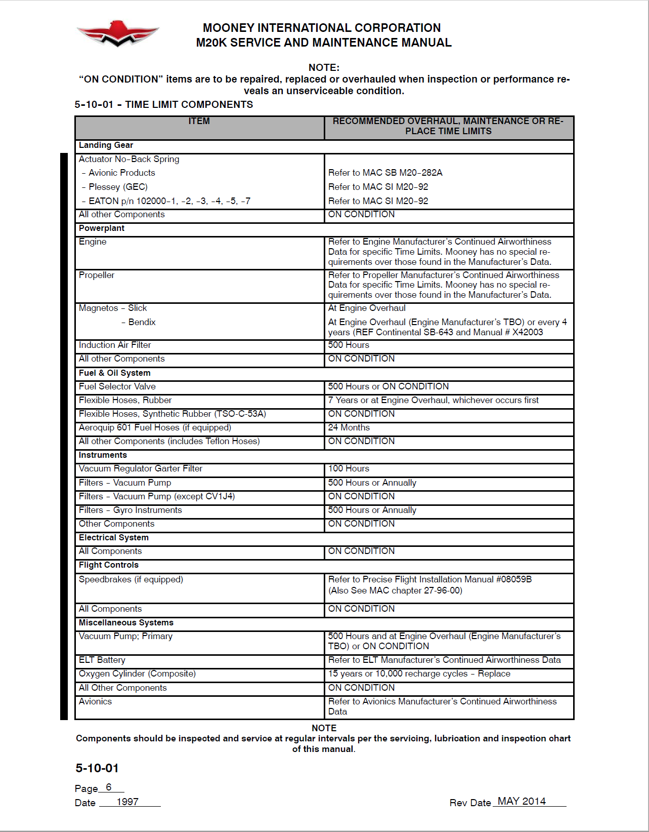

Wow, I did not notice that till you just pointed that out. I miss-assumed that all of Section 4 was titled Airworthiness Limitations Section - but its not. Section 4 is ICA (Instructions for Continued Airworthiness). Since only the ALS (which is only 4.1) defines mandatory requirements and there are none listed in 4.1, I believe you are correct and therefore the Section 4.3 is not mandatory. My bad for misconstruing the section titles and mistaking 4.1 for being all of 4.  Just to be sure though, I'll double check with my team, but I believe you're right.
11 hours ago, kortopates said:
It only has to be approved by the FAA, just read the first page of section 4. AD's need to go through a NPRM, not Airworthiness Limitations.
Its true that we don't really have any but the no clutch back spring in the gear actuators in the Mooney, most are on condition, but here is a example Mooney list for the K model:
Thanks for clarifying that, I thought AL's needed to go through the rules-making process as well.
Hey wait, is the no back clutch spring an Airworthiness Limitation just for K models on?  I couldn't find any AL section in the J service manual, nor did I see it on the page you posted from the K manual?
Negative on the No Clutch back spring - I was mixing apples and oranges into the discussion and should have clarified. What I posted was only the Maintenance Manuals Time limited components and I should have clarified - I listed it really to your point earlier when you used the word "rare", I thought you were referring to Mooney's time limited component section where we don't have any but the reference to SB's for clutch. But I should have included these are an example of non-mandatory requirements for us Part 91 operators since because they are not included in Section 4 - Airworthiness Limitations Section which I'll post below.
These changes came about just a few years ago at the direction of the FAA to include Airworthiness Limitations Section 4 in the maintenance manual. Previous MM revisions did not include a Sect 4, just a Section 5. Also they cleaned up Section 5 and made it much more conservative. For example they use to cite the Engine manufacturers TBO limits, but now they refer to the OEM's Continued Airworthiness Data instead which is a much cleaner way of doing it and really leaving it up the OEM to define any "mandatory" requirements since they would be the only ones that could (not that they would) - but certainly  not Mooney.
Notice also that section 4 is FAA approved and it only references serial numbers starting with the Encore (2000 and up) and foremost it doesn't list any of the items we see in Section 5 - in fact its blank. That's because we have a plane that has very few certification requirements under Part 23. In contrast, Cirrus is certified entirely under part 23 and they have lots of expensive mandatory items listed.
I don't recall if the J model was similarly updated, but all the longbodys where just like this.

If I understand correctly, the gist of the Cessna 210 case was that even if the manufacturer got the FAA to approve an item in the ALS of the maintenance manual, that would only be mandatory for aircraft produced after the item was added to the ALS.
That means even if Mooney got an ALS item added to the J model maintenance manual, it would be mean absolutely nothing since it would only apply to J's made in the future, not the past.
This is true, FAA legal has stated from regulatory standpoint only the OEM maintenance manual from when the plane was manufactured applies. But reality is you won't find any shop in the country that operates as a repair station that can get away with this. As a part of doing business each repair station must write up an FAA approved operations manual that covers every aspect of how they do business from training to documentation. Of course they will all say that they will follow the latest OEM documentation for controlling their maintenance. Such repair stations have their hands tied behind their back with respect to this. But in such a situation as this, an owner can always ask for them to complete the annual inspection with a list of discrepancies and have another A&P make an appropriate entry to clear the discrepancy.
