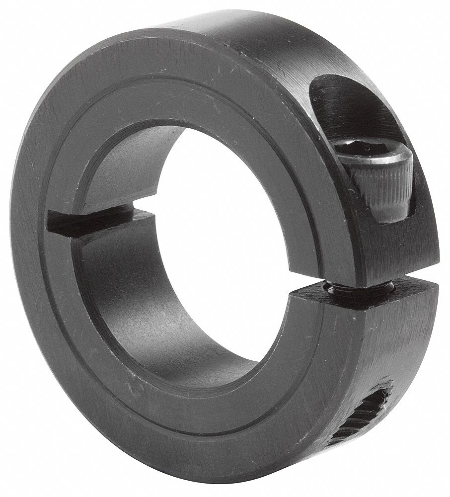

EricJ Posted October 15, 2017 Report Posted October 15, 2017 On 9/25/2017 at 3:18 PM, HRM said: You just need to tighten a collar around your shaft, like this one from Climax: I went in a whole different direction when I read that. 1
