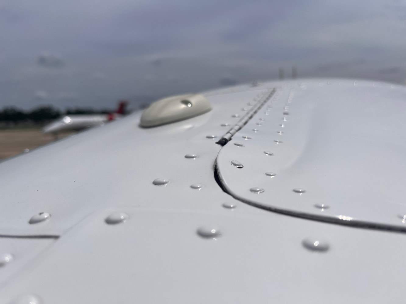

zehutiman Posted Sunday at 01:29 PM Report Posted Sunday at 01:29 PM Yep, my baggage door on my 1980 M20J Missile popped open during climb out. No doubt it was due to me not closing it properly, but I’m wondering if anybody else has had that happen and what they did repair-wise. Mine still closes surprisingly easily, but there’s an unmistakable crease in the door, near the hinges. Quote

kortopates Posted Sunday at 03:40 PM Report Posted Sunday at 03:40 PM The only real repair is a new door. The new door skins are made a bit oversized to be trimmed to fit your plane.You can look at used salvage doors but the odds of one fitting your plane well isn’t good.I trust the hold open arm had to break off to allow the crease to form.Sent from my iPhone using Tapatalk Quote

N201MKTurbo Posted Monday at 02:35 PM Report Posted Monday at 02:35 PM It would be fairly easy to fix the door. It is a flat piece of sheetmetal riveted to a pressed inner piece. I would drill out all the rivets and separate the two pieces, straighten out the pressed piece, use the outer skin as a pattern to cut out a new skin, then rivet them back together. I could probably do the whole thing in 6-8 hours. Then you have to paint it. You would probably need a new seal. 3 Quote

M20F-1968 Posted 5 hours ago Report Posted 5 hours ago On 5/18/2025 at 11:40 AM, kortopates said: The only real repair is a new door. The new door skins are made a bit oversized to be trimmed to fit your plane. You can look at used salvage doors but the odds of one fitting your plane well isn’t good. I trust the hold open arm had to break off to allow the crease to form. Sent from my iPhone using Tapatalk I had the opposite experience. When I did my rebuild, I took the baggage door off a 1998 Ovation. The pulled the hinge pin and mounted a new 1/2 of the airframe side of the hinge to the airframe and left the door completely alone, even the door seal. It remains this way today. The door seals well and fits the opening well too. My experience is one of one, but it would seem that a used door would likely fit. The door swap also gave me the new latch mechanism with the inside opening handle as well. The passenger door was more complicated as I reskinned my original door and put in the Ovation hardware - but that was a different project. John Breda 1 Quote
Schllc Posted 1 hour ago Report Posted 1 hour ago The repair is pretty straightforward. The tedious part is trimming the outer skin to fit perfectly. Someone familiar with sheet metal and riveting could certainly do it in a day with the right tools and expertise. a weekend warrior could do it as well, but without the right stuff it’ll take a while. it is not a major repair. Painting was the biggest pia of the whole repair. Quote
