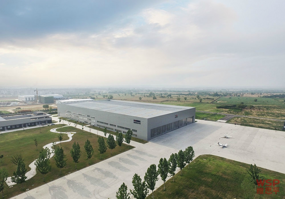

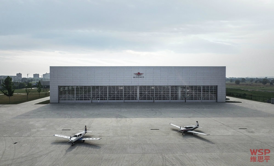

They purchased an acclaim, disassembled it in Kerrville, shipped it to china and reassembled there. I found very limited information about anything else. They obtained a part 145 repair station certification from CAAC... and that's all.
The subsidary under meijing group that actually is involved with general aviation is called soaring aviation, and their website is no longer accessible. http://soaringaviation.cn/ This company has since went bankrupt as far i can tell from information on the open internet.
There is another company "Zhenzhou Mooney General Aviation", which seems be a subsidary of soaring aviation or meijing group, and their AOC was still valid on CAAC website, lastest I could find is 2022. I believe they are a flight school.
They built a ridiculous hangar in Zhenzhou City which they intend to use it as a manufacturing base for "future" mooney aircraft. They built the hanger but that's about it.
I did found two phone number but I doubt it would be working. Here: +86 0371-56995015 or 0371-68190031. I tried the second number as it was listed as the company's main landline, and it doesn't even connects.
On Google maps, this hangar still stands, no idea who owns it today... But that about all I could find about Meijing.
