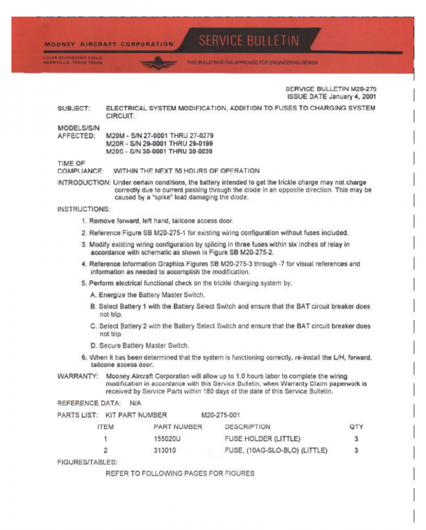

After further investigation I found that the blown fuse was a 10 amp fuse coming off terminal 85.  I see that it doesn't show in the wiring diagram. The fuse in the wiring diagram is a 1 amp fuse (Littel 313001) coming off terminal 88A.  Maybe they added the fuse and didn't update the wiring diagram. I'll replace it and see what happens.

That is confusing.  The only 1A fuse I can find anywhere on that schematic is connected to the Starter Relay (mislabeled a solenoid on the schematic) and it feeds the START POWER annunciator circuit.  It is attached to terminal 88a but although it is the same type, that relay is not Master Relay #2.  If you see another 1A fuse on the schematic I’d appreciate knowing where it is.  How many wires do you see attached to Master Relay #2 terminal 85?  If there is more than one, then it is likely that something has been miswired and it could also explain the blown fuse.  Does the blown-10A fuse holder still have a label, and if so, what does it say?
It is unlikely that the battery selector circuit has an undocumented modification by the factory since schematics for later M20Rs are essentially the same with respect to that circuit.
I didn't see a label on the blown fuse holder. I'm not sure about the other wires on terminal 85. I don't think there were any others attached but I will look further next time I get to the plane.
Sounds like they did the Service Bulletin (M20-275) or maybe yours was made after the Service Bulletin and it came that way from the factory, but you looked at an older schematic before the SB.

https://www.mooney.com/wp-content/uploads/2020/12/SBM20-275.pdf
