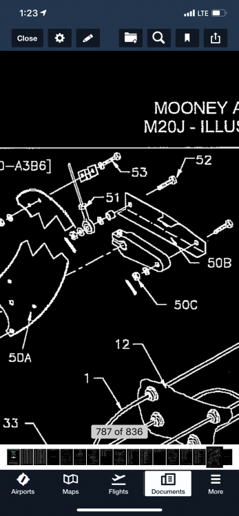

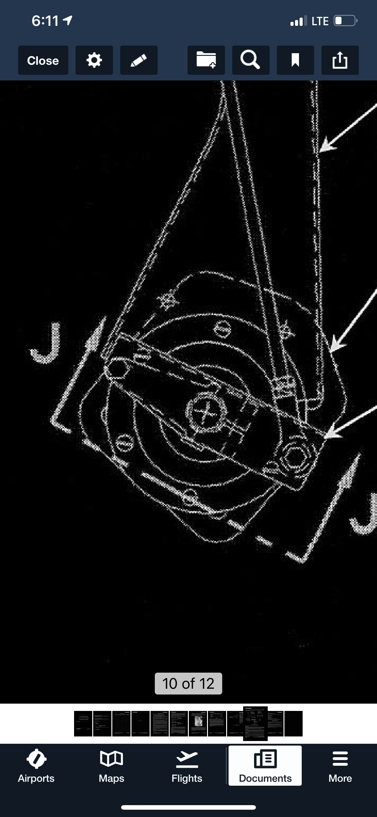

we have it clocked correctly.  its the bell crank bracket that has two different ways to attach it.  The STC instructions show one way, and the IPC shows another.
The bracket is symmetrical and can fit either way.
I would have preferred it the way it was in the parts manual, but this is how the install instructions show it. Flat end on top on these instructions.  First pic is the diagram from the install instructions, second is the IPC
