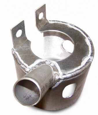

My E was retrofitted to an alternator in '99. I don't think that is where this one went because it is at the back of the engine and the generator was in the front. This is more likely for the fuel pump, I need to take a look and see if there is a shroud. I am really leaning towards plugging the hole to get more air on the 2-4 pair.
Mystery solved.
Apparently the E had a leather cooling hood over the (mechanical) fuel pump, ostensibly intended to cool it and prevent vapor lock on those brutally hot summer days in Tejas. The shroud was fed by a tube coming off the doghouse port that is shown in the diagram earlier.
No surprise that a leather hood would not survive 50+ years. My guess is that after it crumbled away they just pointed the end of the hose at the pump and said 'There!'.
There are metal cooling shrouds available from Spruce, et al, but the homebuilt guys are still just pointing a cooling tube at the pump.
I would really love to see what one of the original leather ones looked like.
