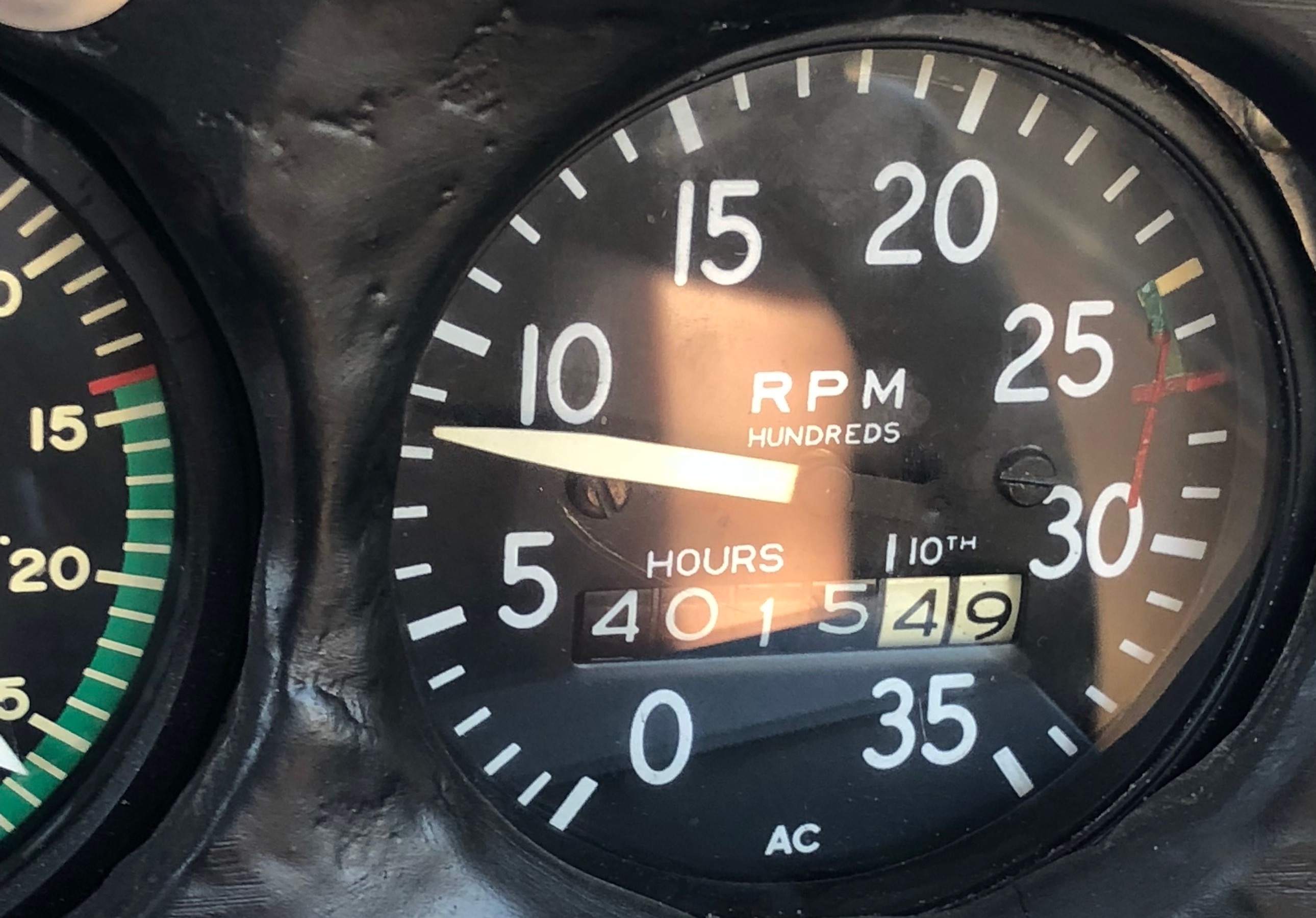

chrixxer Posted September 13, 2018 Report Posted September 13, 2018 Hoping to unravel this mystery. Plane is still at CMA getting its going-through after the emergency landing at Pt. Mugu and the "on the ramp, during mosquito season, overseen by some poor enlisted guy who had to stand watch, while Hawkeyes taxied past" fuel system repairs. Mechanic found a bunch of issues‡, and I had some concerns, so I green lit anything he found that needs doing ("blank check maintenance"), culminating in a full, several months early, annual. One of the squawks was the fuel pressure when I departed Mugu (reading about 34 PSI, above the green arc). (We replaced the fuel servo - RSA-5AD1 2524054-11, same part no. that came off the plane, and the mechanical fuel pump (LW15473).) Mechanic thought it was air in the lines, or a sticking gauge, green lit me to fly it, but it's not doing anything more than that 6nm ferry flight until it's 100%, including showing fuel pressure in the green arc. Mechanic (a referral from another MooneySpacer, local to CMA, who was able to jump in and do the expedited repairs required when it was parked on the Navy's ramp) now thinks the wrong fuel servo was / is installed. Pacific Continental told him the 2524054-9 is required. But as I read the TCDS, what comes after the dash is sort of meaningless in this context. For the M20F (p. 22 of 58), Engine is specified as: "Textron-Lycoming IO-360-A1A (Bendix fuel injector, Model RSA-5AD1, P/N 2524054-1) See Note 20." Note 20 reads: "The dash number following the injector setting number indicates manufacturing revision level of the injector and does not change or dictate the setting of the injector." The only 4-cylinder "-9" part I see in the Application Guide is the 2524450-9 for the IO-360-C model, which, interestingly, this engine was, originally, circa 1978 (at which point it was equipped with a 2524450-2). In 1985 this engine was converted from a -C1C to an -A1A, with a 2524054-10 fuel servo (among other changes), and installed in this Mooney. (There's no indication as to why, just an entry 8/12/1985 that mentions removing the old -A1A, and a 10/21/1985 entry that documents: "Installed Lycoming IO360C1C change to IO360A1A" with the serial numbers for both engines.) So, am I right in my understanding the -9/-11 after the 2524054 part number is a non-issue? Wonder what else could be going on. ‡ The mechanic's summary (pieced together from text messages and edited for flow): "You have a solid airplane however some basic maintenance things have been neglected. You have already paid for the expensive things like the fuel servo and the fuel pump which looked like it was due to be replaced, based upon the cracking I saw on the outer edges of the diaphragm. The mags are long past due for an IRAN check, about 600-700, and new wires are in order, about $350. The front baffle need to be properly installed to eliminate the rubbing on the flywheel (that seems to be happening since the cylinders were replaced?), and a few cracks in the nose gear inner we’ll need to stop drilled. The mag P Leads are ancient. And should be looked at for replacement. The fuel pressure gage seems to be sticking but it makes full fuel pressure. I replaced one of the scat tubes for cabin heat since the internal spring was missing and the hose was completely collapsed. The brake pads haven’t been changed in a very long time and are worn enough to warrant replacement. It looks like the rear elevator bungees were not cleaned or lubricated in a really long long time. They are supposed to be removed, cleaned and repacked with grease. There are a couple of flat spots on your mains tires but otherwise they are in good shape [this would have been the result of my landing at Mugu; I kept altitude maybe a bit too long and slipped it down over the arrestor gear, but came into the flare at about 100-105 mph, and only had 3500' to work with ... I know I stood on the brakes once I finally got the wheels down]. The compressions are really strong which is very good news. You have fine wire plugs on the bottoms and massive electrode plugs in the top. They cleaned up fine and tested good so that’s good too. One of your magneto coils was badly cracked. They do that with age and is a precursor of failure." Most recent updates were earlier this afternoon, prompting this post: "The plane is almost done, mags are in and we are sorting out fuel flow, pressure issues. I did a compass swing and am preparing the new correction card. The landing lights are tight and the covers have the mounting screws all in place. There were two missing screws missing from the corner mounts. We solved the VOR antenna mystery in that the other side is almost broken the same way the other one was. I never would have expected stainless steel to fracture like that. I will send the video of gear swing and manual gear deployment. Both were perfect." Followed by: "So we could not understand why the airplane was not behaving as it should, in terms of fuel flow and pressure. It turns out that your airplane requires a 2524450-9 fuel servo. What we took off and what we put on was a 2524450-11 [sic]. It appears that your airplane had the incorrect fuel servo." ... And this, ladies and gentlemen, is why you buy a plane that costs about 80% of your total purchase budget...

chrixxer Posted September 14, 2018 Author Report Posted September 14, 2018 47 minutes ago, N803RM said: Chris, has the fuel pressure gauge been checked? Gauge always showed in the green for me. Ron Yeah, and it was fine (in the green) before all this happened. It was only after we replaced the fuel servo and mechanical fuel pump we started seeing this. July 1st it was at ~26.5 psi, electric pump off, at idle. July 31st (after the emergency landing and the servo / pump replacement), electric pump off, 11000 rpm, ~34.5 psi.
Ron McBride Posted September 14, 2018 Report Posted September 14, 2018 Chris, have you tried a different gauge?
chrixxer Posted September 14, 2018 Author Report Posted September 14, 2018 Chris, have you tried a different gauge? We don't think it's the gauge (which was working perfectly before all of this).Current plan per A&P: "We are soaking the fuel injectors in Hoppies and will install them and lean the fuel servo in the morning. Everything else is correct so we will get it right. We will measure fuel rail pressure but the high reading is air in the line from the system being opened up."Sent from my iPhone using Tapatalk
