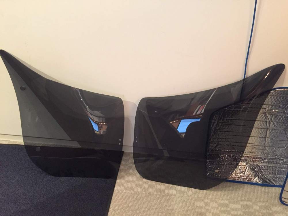

I was out yesterday and replaced the tint on the one rear window that had gotten scratched up. I took pictures and wrote up how to tint your windows. I know many of you have already done it but others have expressed apprehension about doing it. Take a look at how easy it is. (And if you mess up a couple of times one roll of tint for $13.00 is enough to make a few mistakes and still have more left over.
Window Tinting - Made Easy

The glued on tint used by auto tint shops will likely bubble as the plexiglass breaths and the tint/glue doesn't. The tint that @Skates97 recommends and I used as well, also breaths and is just using static cling to stay on the window. I've not had any bubbling in mine and it's been about a year.
I tinted the windows of my previous truck using stuff from walmart and a spray bottle of water. Avoiding bubbles is all in good prepararion, plenty of water, and working them out immediately. Gotta be clean before putting on the tint, and have a nice, clean piece of microfiber handy to wipe from the middle out to the edges.
The disadvantage of tinting plexi is that you can't make an approximate trim, position it, then trim with a knife affer it dries . . . .
