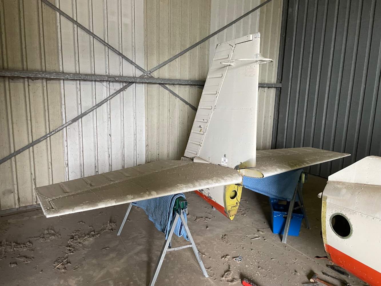

Fly Boomer Posted February 6 Report Posted February 6 59 minutes ago, Andrew T said: Step 1 is the separate the fuselage from wing and get it on a truck. As @LANCECASPER suggested above, don't spend any money or time until you have verified with a qualified mechanic that there is no terminal corrosion. Once it gets started, there is usually no financially realistic way to correct it. If you get past that step, do what the Mooney experts do: remove the tail. Here is how Don Maxwell moved the M20T Predator prototype when they were bidding on a government contract to build military flight training airplanes: 5
Andrew T Posted February 7 Author Report Posted February 7 11 hours ago, Fly Boomer said: As @LANCECASPER suggested above, don't spend any money or time until you have verified with a qualified mechanic that there is no terminal corrosion. Once it gets started, there is usually no financially realistic way to correct it. If you get past that step, do what the Mooney experts do: remove the tail. Here is how Don Maxwell moved the M20T Predator prototype when they were bidding on a government contract to build military flight training airplanes: Thanks for this, lots of rivets.
Hank Posted February 7 Report Posted February 7 30 minutes ago, Andrew T said: Thanks for this, lots of rivets. Much less work than removing the wing and building a cradle for the fuselage.
Sabremech Posted February 7 Report Posted February 7 Moved an M20 recently. Removing the tail section isn’t that bad. You’ll have some bolts holding it on to the steel cage structure, then the rivets on the skin. 1 1
