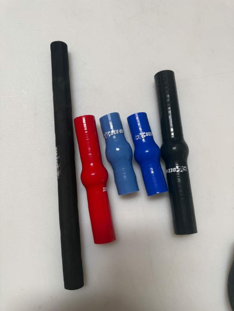

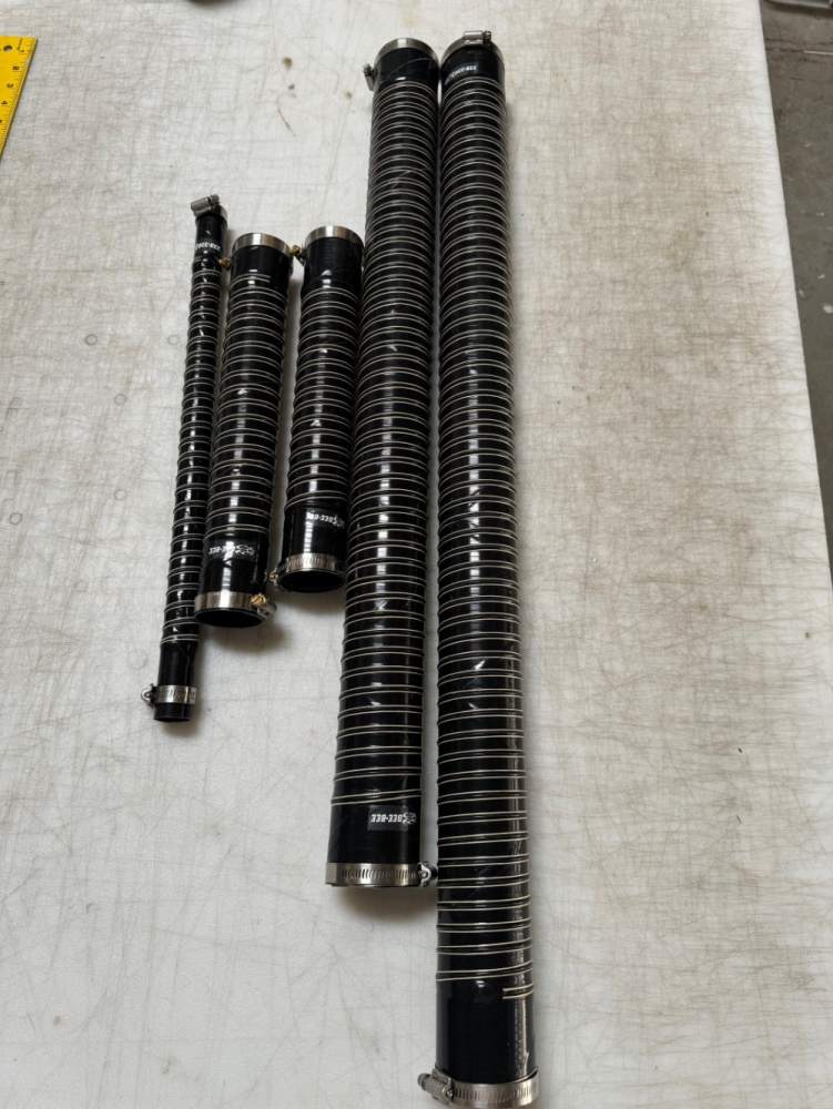

Breeze aerospace
lined clamps
94 series
I stock all sizes 1/2 to 4"
we use on all of my ducts or silicone hoses
You can do things based on cost or quality
we ship our ducts or hoses with a flex 8mm screwdriver vs a flathead screw driver
Today we shipped a complete duct set for a MSE model .
Were the only mfg in the industry that has all of the different sizes .

There are std Groved clamps and double wall 94 Breeze series.
stainless steel with stainless steel nut
8mm
We buy bags of 500 in various sizes for ducts and hoses.
we sell hose and clamps to Rapco for there kits .
Cost is less than 1.50 in 3/4 I.d.
This is why we include at no charge.
We mfg molded silicone hoses for fine automobiles in various colors, but the matte black finish on a German auto is perfect.
seadoos
Motorcycles
Automotive
Vespas
If it's nla , we will mfg it
cheers to those who want the Best
