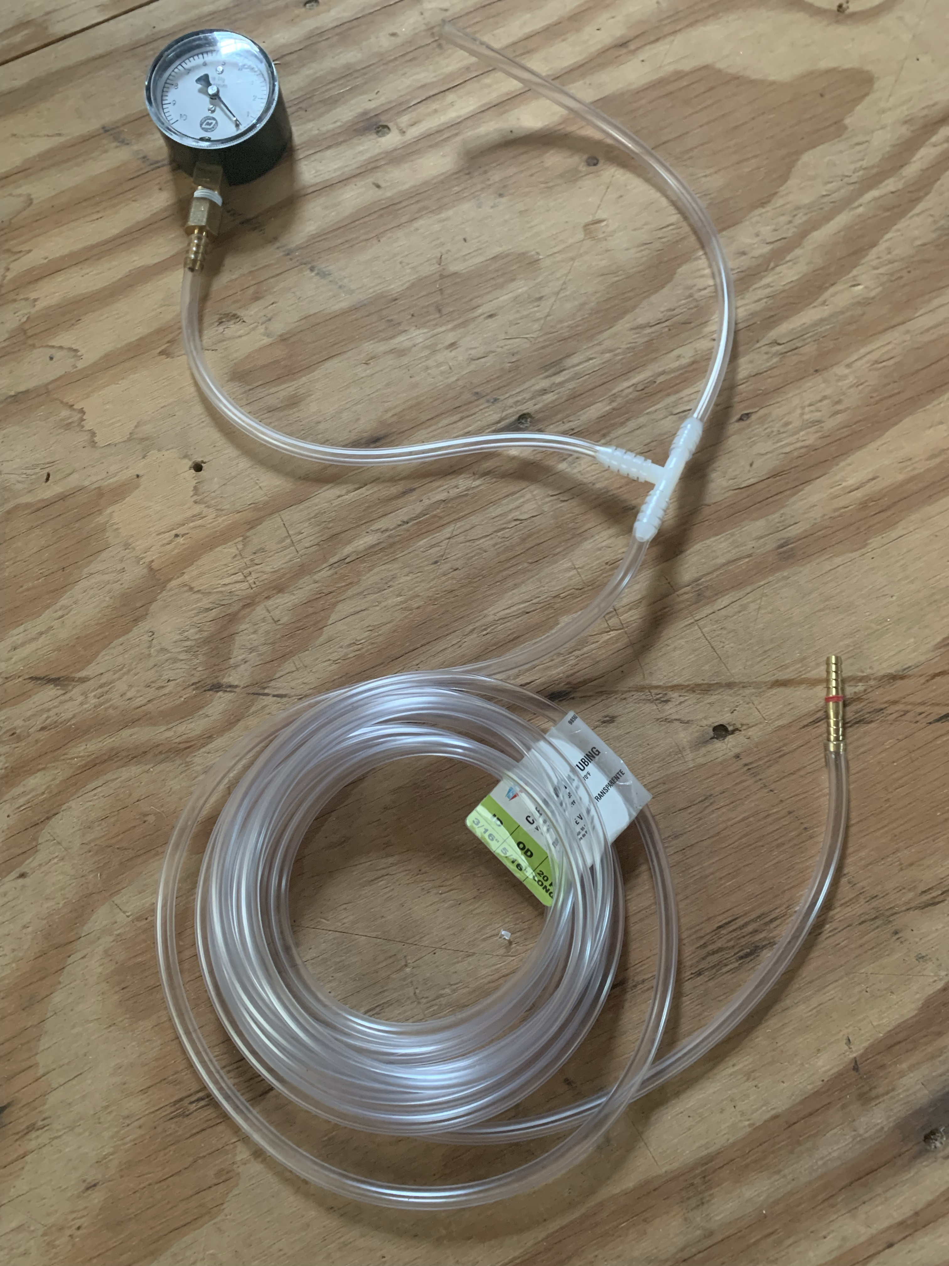

Mine was tested for leaks by removing the vacuum lines at the turn coordinator.  Once the side with the leak was isolated (red or green line), the leak was further isolated to the rudder or aileron by pulling a vacuum in the tail at the rudder servo.  My leak turned out to be a rudder servo.  You may be able to find the leek without removing anything.  An inexpensive vacuum pump with a gage from harbor freight worked fine if you get a good seal when you attach it to the hose.
