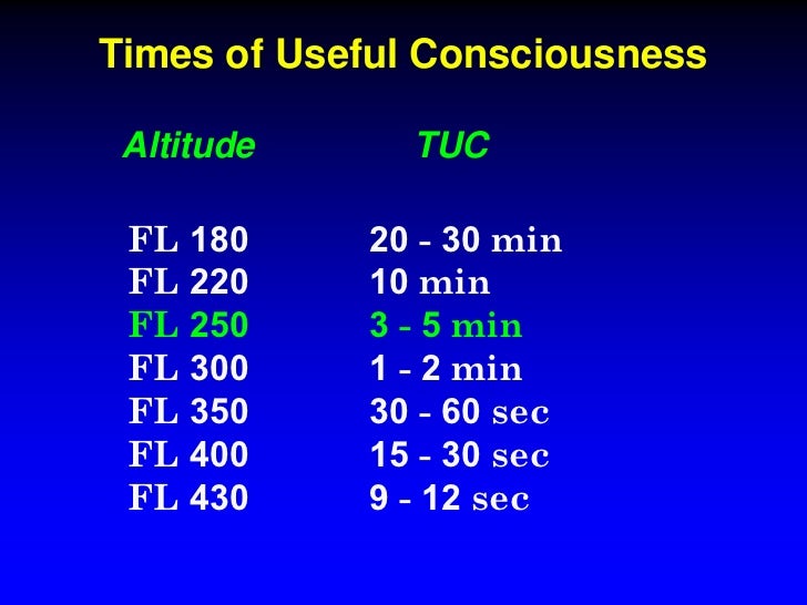

As far as how high is safe:  That probably varies for everyone.  I am comfortable with FL210 and I will explain why.  Having been in an altitude chamber, I know what it is like at FL250 and it is MUCH more rapid onset of symptoms and you will find yourself in bigger trouble a lot faster than at 210.
Looking at the TUC chart acem-2011basic-aeromed-sutuspan-15-728.j
So, by staying at FL210 or lower I have 10 min.... go to FL250 and you drop to 3-5min.  And believe me, the 5 min is for the youngsters.  More than likely if you are 30 or older it will be closer to 3 min.
Now, keep in mind, if you found yourself at FL250 with a failed O2 system and symptoms of hypoxia (which you will feel IMMEDIATELY) , you dont need to get down to only FL 180, you are ALREADY hypoxic, you need to get much lower, probably 12,500 or less.  So you have 12,500 feet to lose and you need to do it pretty quickly.
I can pop speed brakes and reduce power a few inches and come down at about 1500 FPM at the yellow arc.  That will take 8.3 min to get down to breathable air.... IMHO this is simply not fast enough.  So, from FL250 if I have an 02 failure I need to be making a large reduction in power and getting that rate to more like 3000 FPM which will get me to 12.5 in 4 min.   This is certainly achievable, however I now put my engine at risk of shock cooling.  Or at the very least subject it to large rapid changes in CHT which is also not good.
I don't want a failure of my 02 system to be a major event.  If I limit myself to FL210, I start with 10 min of Useful consciousness,  which in itself is plenty of time to 1: see if the problem can be solved, say by plugging the scott connector back in!  and  2.  begin a much more normal descent down to breathable air.
You give up about 8 knots staying at 21 vs 25.     Over A full tank of fuel that gives 5 hours of cruise flight, this is less than 15 extra min of flying.
I've always been confused by tables like that.  9 seconds to not conscious at FL43?  I understand its very unhospitable up there, but most of us can simply hold our breath right now sitting where we sit, for maybe a minute.  We can go underwater for a minute.  Some people can hold their breath for five minutes, and more.  How can it be that thin air causes us to go unconscious within 9 seconds?  I am not doubting - I know that table is carefully researched - I am declaring this is a point of confusion I would appreciate if someone can explain to me the seemingly contradictory things here.
Yea, seems strange I know.   it sort of just pulls the oxygen right out of you.  remember, when you are holding your breath, there is air in there... when you decompress, that air is either coming out of you or exploding your lungs if you try to hold it.
At our breathable altitudes, even if you exhale completely, there is still more air in your lungs than at those extreme altitudes.
On top of that, the  partial pressure is very low and thus you cannot as easily absorb the tiny amount of O2 that is present.

I'm no medical expert.     Here is what I think is going on...
I think it takes more than 9 seconds for the oxygenated blood in your lungs to reach your brain, so there has to be something going on that acts on your entire circulatory system at the same time.
So if we consider the pressures and partial pressures, and pressure differentials, how about this as a theory....
Your cells need a oxygen pressure differential in order to oxygenate themselves that is an absolute differential.  Let's call it 0.5 PSI (I'm sure anyone with medical training is screaming in their heads on on their keyboard at me right now!  Just be glad I didn't measure it in cars per football field).    So without a 1 PSI difference in the partial pressure of the oxygen in the blood and the partial pressure of oxygen in the cells, the cells will not absorb the oxygen in the blood.
So when the atmospheric pressure is 3 PSI (21% of 14 PSI)  your blood has maybe 2.5 PSI, and then your brain cells have 2 PSI.   Life is good.
When the atmospheric pressure drops 7 PSI (18,000'), the air has 1.5 PSI, blood now has 1 PSI and your brain cells have 0.5 PSI.  Not good but not instantly deadly.
When the atmospheric pressure drops to 3.5 PSI, the air has about 0.75 PSI, blood has 0.25 PSI, and the brain... Has nothing.
This is just a half-baked theory.   I did have a cup of earl grey tea this morning, but I did not stay at a Holiday Inn Express.
