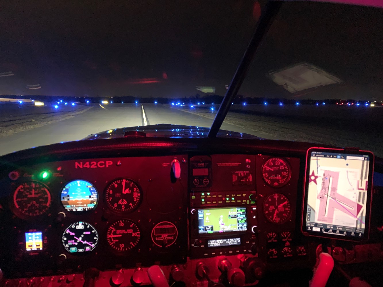

These little red 12v LED spots are the perfect addition to the existing overhead lights.  Keep the existing overhead lights - the rheostat needs the resistance of the incandescents to dim properly - and simply tap into the wire going into one of them.  The LEDs dim along with the incandescents. They are adjustable so you can point them anywhere such as the flap and trim indicator, or places on the panel that the main overheads don't cover well.

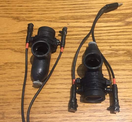

I've had two of these little spots for about five years now and they put controlled light EVERYWHERE I need it.  I started out with four (photo) but that was overkill.  Two are plenty. I added them to the existing bezels with wire ties (on top of a bit of insulation since the bezels get hot from the incandescents).

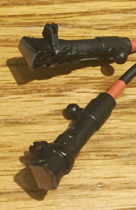

What are the "binocular" protrusions?
Bulb goes in one hole…
Light comes out the other… 90° from each other…
Do you mean the area at the tip that looks like an end cap?  I had forgotten about this- at full brightness the LEDs were a bit too bright for my taste, so I cut some tiny strips of gray-shaded plastic and attached them to the end with another wire tie.
I'm attaching another photo of what the panel looks like when lit with the LEDs augmenting the OEM incandescents.  This is at a fairly bright setting but the point is you can get any level of light you want to preserve your night vision, directed at any areas of the cabin.
My night flying days are probably over, but that looks really good!
