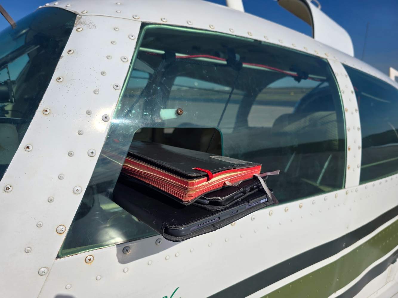

Hank Posted November 13 Report Posted November 13 Our Mooney doors only open ~2" in flight, you won't toss burning electronics out of it. And finding and opening a bag to carefully drop that flaming thing in will be very difficult to do in flight. Check your tablet and see if it will fit out the storm window. My Galaxy Tablet fits (I set it on the panel during preflight / loading through the storm window). That will make a quick, easy open and toss motion, not requiring fumbling around for a bag or leaning across and pushing hard on the door.

LANCECASPER Posted November 14 Report Posted November 14 1 hour ago, McMooney said: throw it out the window ? A phone might fit, but I don't think a tablet would.
