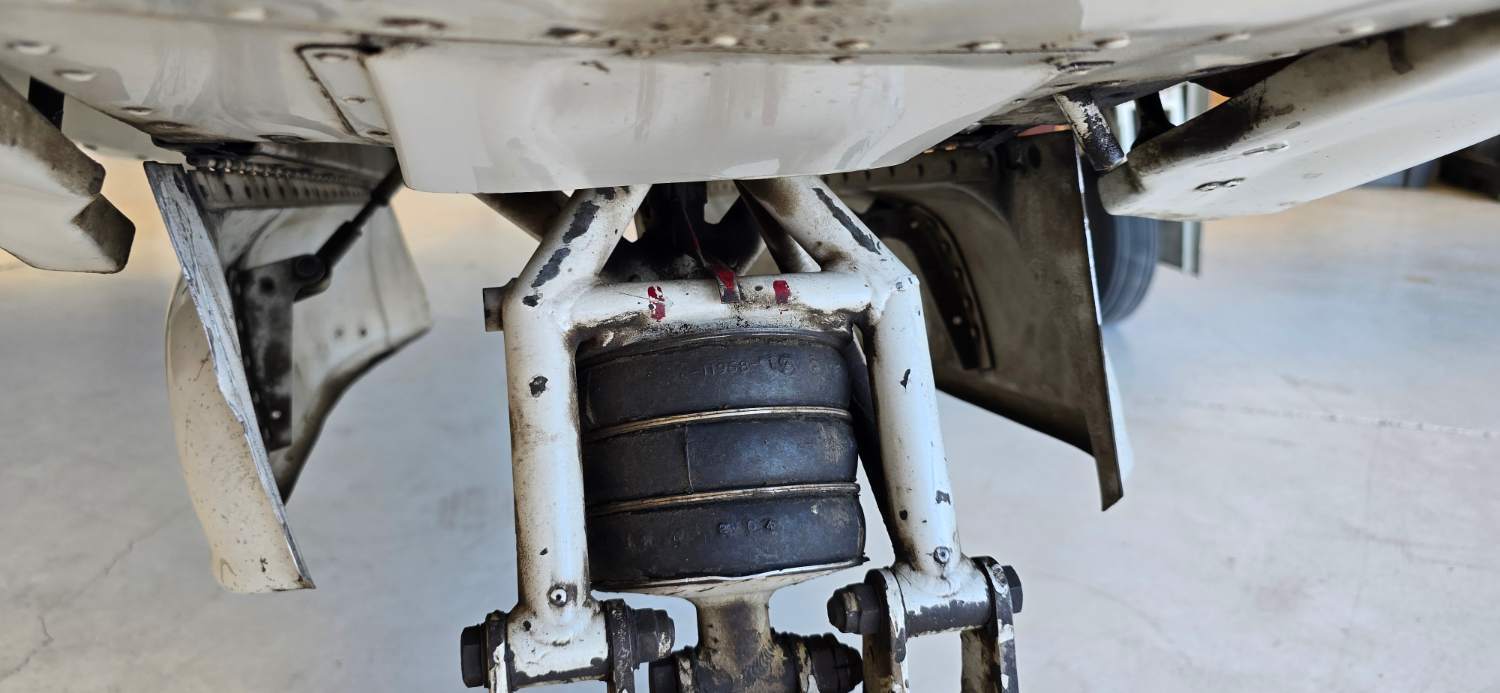

mpilot Posted October 22, 2025 Author Report Posted October 22, 2025 As I've looked closer, the rubber discs are 10 yrs old, so I think it prudent to have them replaced in total and then address the tracking limits once new discs installed. I'll rent the tool (I have it on a browser at the house if member still rents it out) get new discs all around and hopefully have a more confidence-inspiring fast taxi situation. Thanks all for your input, and I'll report back with outcomes.
MikeOH Posted October 22, 2025 Report Posted October 22, 2025 4 hours ago, mpilot said: As I've looked closer, the rubber discs are 10 yrs old, so I think it prudent to have them replaced in total and then address the tracking limits once new discs installed. I'll rent the tool (I have it on a browser at the house if member still rents it out) get new discs all around and hopefully have a more confidence-inspiring fast taxi situation. Thanks all for your input, and I'll report back with outcomes. JMHO, but I'd place odds that you will still have the problem; old shock discs won't cause the tracking problem. While replacing the discs you should take the opportunity to check all the bushings and washers for wear and replace as necessary. Otherwise, you're going to be pulling things apart, again! 1 1

mpilot Posted October 23, 2025 Author Report Posted October 23, 2025 Knowing the age of the pucks, and that I want to get in and fiddle, I'll replace them on principle. I'll deepndove on the linkages and ensure tightness and slip are appropriate. Regarding where the issue lies, we shall see, but it taxis at taxi speed very well, it is just once you're around 50 on runway, eg close to rotate and upon landing, where it soils the shorts .. So does fit the service bulletin idea. In the end, it will all be looked at. If you look at the bottom puck, on your lower left there's a tear. Also, from date stamp, it seems quite old (older than I thought, 04, as I was looking at part number stamp on top disc not the date stamp on bottom). It's seemingly time for a refresh.
Hank Posted October 23, 2025 Report Posted October 23, 2025 @mpilot, there should be a full date of manufacture molded into the pucks, MM/YY. Mine were upside down, I thought they were "09/96" but when I replaced them at annual in 2012, rightside up they correctly read "06/69" which is period correct for original pucks when my C model was built in 1970. There were no issues with steering or control, but boy do the new ones feel better taxiing around, and my landings aren't as abrupt anymore. 1
