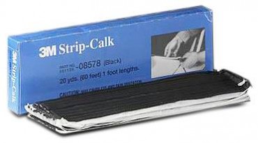

Anyone have suggestions on how best to seal the what I call, "the avionics bay panel"?  While I like the look of the 201 STC, I like the ease of access to avionics, engine mount bolts, etc.  I know my luck, two weeks after I installed a  201 windshield STC every piece of electrical equipment will have an issue, one at a time.  :-)

There was a recent thread on this- you should be able to scroll down and find it- maybe in vintage Mooneys, or in the avionics/panel forum. “3M Strip Caulk” is the replacement for the factory method of sealing, I believe. If you find that thread, there are others who have had success with certain peel and stick weatherstripping.
