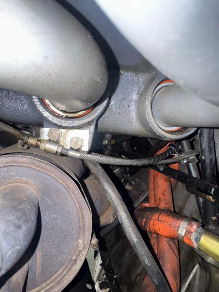

ighazali Posted November 23 Report Posted November 23 Hey everyone not sure if this is concerning. My current oil consumption is about .13qt per hour so essentially 1 quart every 7.6 hrs. Today when looking through the cowl flap door where the breather tube and blowout valve is I saw some oil on an intake pipe. Any ideas if the O-ring may need to be replaced. Oil pressure and consumption seem to be okay. Oil analysis also came back stating a healthy engine.
N201MKTurbo Posted November 23 Report Posted November 23 Most likely running down from above. There is no oil behind the O-rings. 3
ighazali Posted November 23 Author Report Posted November 23 1 hour ago, N201MKTurbo said: Most likely running down from above. There is no oil behind the O-rings. Thanks! So nothing to be concerned? Also is the oil burn normal?

skykrawler Posted November 23 Report Posted November 23 New engine? I guess those are Teflon hoses (replace on condition), otherwise they look kind of oldish. Sources of oil from 'up above' include the rocker box gaskets, rocker box drain B nut connections, intake manifold gaskets, push-rod tube seals, and even exhaust flanges. Engines that 'pool oil' in the cylinder at shutdown can leak it at the intake and exhaust stack connections. One mode of this is oil coming down the valve stems. The #2 intake runner is most susceptible to chewing it's gasket due to it's length. If it doesn't leak out the flange it will likely end up in the induction chamber where the four intake runner connect. The next time you flood the engine some oil will wash out the sniffle valve. But....what you're seeing is a relatively small amount of oil compared to a quart. IMHO. 1

Jsno Posted November 23 Report Posted November 23 Your oil return line clamps probably need tightened. 3
ighazali Posted November 26 Author Report Posted November 26 Had a A&P check it out he said that I was missing a screw on the cylinder head cap which is the grey caps towards the top of the engine, however that cylinder was not the issue. He said the front cylinder cover cap had a bit of oil so it might be the gasket. However, he tighten the cylinder head cover cap and then told me to keep an eye on it. If it still leaks it may need new gaskets where the cap goes. Will keep you guys updated. 1
Ragsf15e Posted November 26 Report Posted November 26 9 minutes ago, ighazali said: Had a A&P check it out he said that I was missing a screw on the cylinder head cap which is the grey caps towards the top of the engine, however that cylinder was not the issue. He said the front cylinder cover cap had a bit of oil so it might be the gasket. However, he tighten the cylinder head cover cap and then told me to keep an eye on it. If it still leaks it may need new gaskets where the cap goes. Will keep you guys updated. Those square caps cover the rockers and are a common leak source. When you look closely at them, see if you can tell what kind of gasket is in there. There’s an older cork (or paper?) one and a newer silicone type (Ive seen orange). Both can leak if too loose or too tight, so that sucks. I have had better luck with the silicone ones. 1
Nico1 Posted November 26 Report Posted November 26 On 11/23/2025 at 3:55 PM, Jsno said: Your oil return line clamps probably need tightened. Check this. Follow oil return lines Under the cylinders, pita to reach. 2

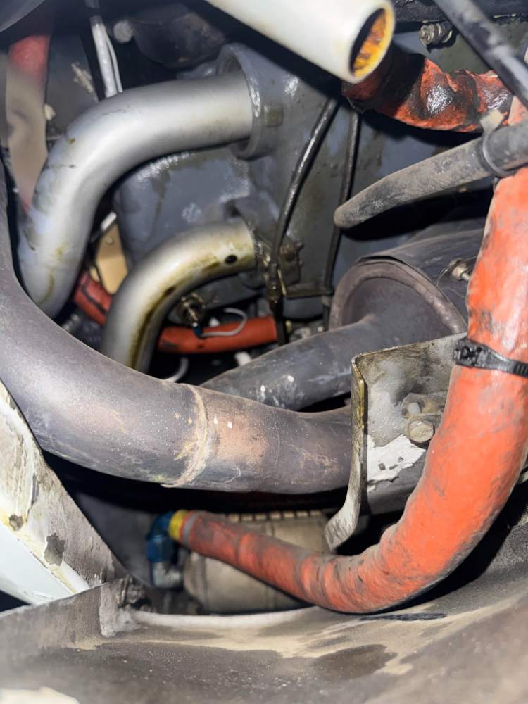

ighazali Posted December 4 Author Report Posted December 4 This is the picture on the pilot side. The front silver tube has a few drops of oil right at the bottom of it.

Yetti Posted December 4 Report Posted December 4 That oil is running down the engine block and collecting there. Most likely place is the Oil drain back tube clamps. 2 clamps over some rubber hose. If you have the thumb screw type, they can be tightened with a 1/2" or 7/16" 6 point socket since it will fit over the thumb part. A 1/4" drive set with some flexible joints will make getting to them possible. A flexible socket drive should work for hex style band clamps. 1
MikeOH Posted December 4 Report Posted December 4 Another 'vote' for the oil drain back tubes; specifically, the short rubber section between the 'hard line' and the case. Mine were hard, cracked and therefore not sealing.
