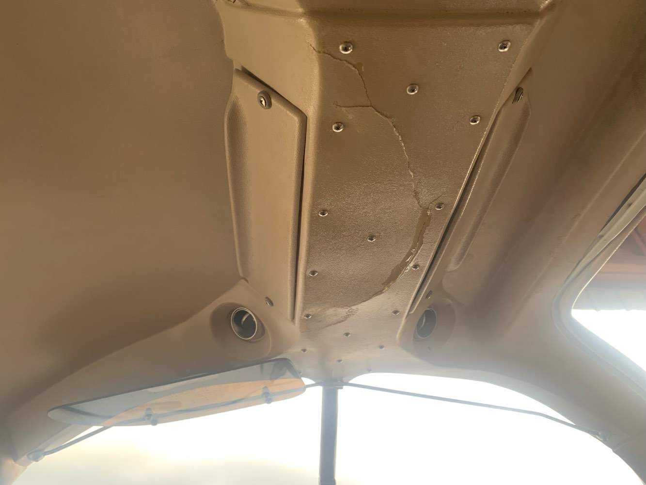

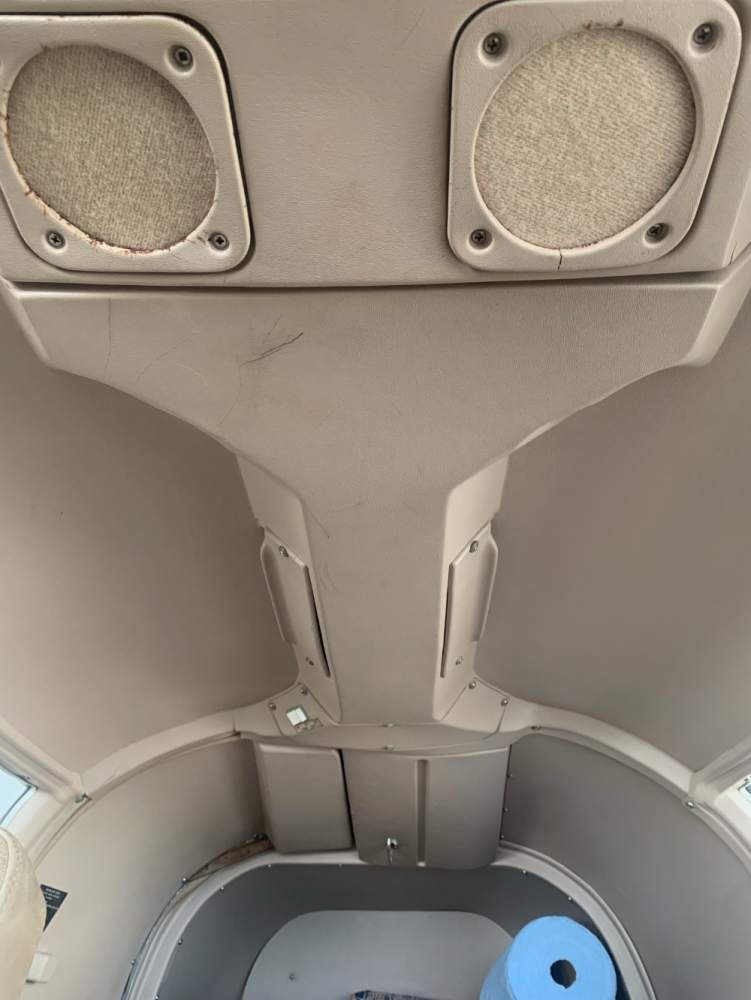

Where do you all source these? My google fu is weak. Most the damage is on the forward part of the console which has been repaired in the prior to my ownership and looks like it needs another repair.
If I can't source one, has anyone here repaired one? My understanding is that they can be repaired but I'm afraid more damage will happen as I take it in/out for repairs.
IMG_8060.JPEG.0c5d7142ce3a4531bee9a40124e78200.JPEGIMG_8061.JPEG.ac53aa66b4b6c0b5a7355c0c8bd7712f.JPEG

I think this is fixable with some patience and Bruce Jaeger's kit. I repaired cracks in my headliner and other interior pieces using this kit.
https://www.jaegeraviation.com/Do-It Yourself Plastic Repair Kit-2017.pdf
Another option is to send the piece(s) to Hector at Aero Comfort and have them covered. His work ios awesome and worth every penny.
I had not seen the DYI on his website. That is AWESOME. Thank you. DYI looks like a realistic option.

I don't know how skilled or handy you are working on your Mooney, but if you have never worked on and removed your interior before this can be a time consuming and frustrating project. Over 25+ years, I have done it more times than I care to recall.  It is still a pain in the ass.
  1. In order to get that front headliner off, you will need to remove the front and rear plastic side panels
    1. To do that the front seats need to come out.
    2. The kick panels need to be removed on both sides.
  2. There are a lot of screws of all sizes
    1. Bag each set by location - don't mix up the location of short screws with the location of longer screws
    2. Do not use any sharp pointed screws in the side panels.
      1. An avionics shop substituted a long sharp screw one time on my plane side panel and proceeded to drive it right into a cable that was zip tied to the steel frame.
  3. The headliner removal and replacement can benefit from two people handling it.  It gets brittle over time and if you are holding it just by one side you can crack it by its own weight and do more damage than you started with.
New plastic panels are no panacea.  Every Mooney is slightly hand-made.  Those panels, even from Mooney, are generally oversized and need to be trimmed to fit perfectly.
And then there are all those screw holes.  New plastic panels do not have any screw holes.   If you want to hit all the existing holes, you need to use the old panel as a template in order to mark them. It is easy to screw up.  Otherwise you have to drill all new holes in both the new plastic panel and the aluminum. This is also easy to screw up.
I prefer to repair my existing panels and utilize all the existing screws and screwholes.
Now in your case someone has put a lot of oval headed screws in your headliner - perhaps a backing plate?  It is pure overkill.  The panel should be smooth without any screw heads.
Every owner faces this interior problem.  Good luck however you choose to proceed.

I called my IA and the project has started. The front overhead console is out, the most time consuming task was unhooking things from the overhead console and marking wires. Only the pilot side panel had to be removed to gain access to the front overhead console. It appears there were multiple repairs with various construction techniques. I can confirm that epoxy is a poor choice; repairs done with epoxy cracked again and I'm able to peel off the epoxy, although I do believe surface preparation likely also had to do with it.
Home Depot/Lowes no longer carry ABS on the shelf so that's been ordered. I have some leftover cloth. The plan is to see how well the ABS can be fixed before a decisions is made as to whether new pieces will be ordered or fix what is there. I'll be out of town 3 out of the next 4 weeks so if I have to order things, it hopefully won't really delay the project. I am hoping to hear from @201Mooniac about the fit from Vantage as I still haven't heard back from LASAR on a quote.
Since the rest of the interior is having to come out, the rest of the interior will be done as well. I need to choose a color scheme as the seats will be going out and replacement carpet coming in.

I had too much trouble with the one from Vantage so I got one from Mooney. The two speaker grills would not fit and the center section with the switches and air flow control didn’t fit right either. If all of the parts had been available from vantage I expect they would work but mixing the Mooney and Vantage parts didn’t work well.

The interior is out and I've started to repair the plastic. The last person who worked on it loved epoxy and metal to fix things, especially on the overhead console. There was a 1/4 inch or more of epoxy. I've removed the metal and ground down the epoxy so that proper fix can be done and I'm going to start on the overhead console this weekend. If I can salvage that, I'm hoping to limit what I need to order from Vantage. I did a couple of test with other parts and it appears that ABS cement and cloth works wonders. I'll use EZ sand and follow the Jeager process to complete the project.
I've enjoyed having interior out because I can really look around. The list @1980Mooney shared was completed yesterday (except for replacing the fuel line). I also had my IA look at things for SB208. It appears it had been completed before including new insulation; I did not recall that in the log which matches handwritten notes that I found earlier this year.
The seats will be redone in Lexus leather, with flame certs, by a local upholstery shop. I think I have the carpet selected, they just need to ensure that it will also have flame certs before I order it. I'd prefer to find a local place for the trim that goes around the windows so that I can see the color first hand.
One of my remaining items to figure out is the fabric for the speaker covers.

@PT20J was right on the colors. None of the colors were right for what I wanted so I had a custom color made up.
I put this project aside for a few weeks as I couldn't wear a respirator while my nose was healing post surgery. Structural repair to the overhead console is done and I've started to paint some parts. It's nice to see some progress but I wonder if I went too light on the color. We'll see when the whole interior is back in. Worst case, it will all come back out and get repainted. My interior had more damage than I realized but it's all fixable, it just takes time.
How is the wemac assembly removed? The wemac seat is glued to the backside of the overhead console and I'm afraid that if I cut through it, I'll end up doing damage on the finish side of the overhead console. I'd like to avoid doing that but they need to come out so that I can paint the area properly.
The upholsterer is working his magic on the seats, I expect to have them back this week. I need to order the carpet; I got the burn certificate for it today. The hardest part is finding someone locally to serge the carpet as it seems everyone does binding instead.
