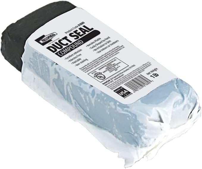

PT20J Posted April 22, 2024 Report Posted April 22, 2024 Get some duct seal from the hardware store. It works great for sealing openings like the wire pass through to the tailcone.
