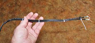

EricJ Posted October 21, 2023 Report Posted October 21, 2023 That's a VOR antenna. You'll need the balun-type cable to connect to it. Like this: 3

vik Posted October 24, 2023 Report Posted October 24, 2023 On 10/20/2023 at 9:21 PM, EricJ said: That's a VOR antenna. You'll need the balun-type cable to connect to it. Like this: Your V-dipole looks correct. And pay attention to what EricJ says as this type of antenna will not work without the balun. RG-58 cable is sufficient.
