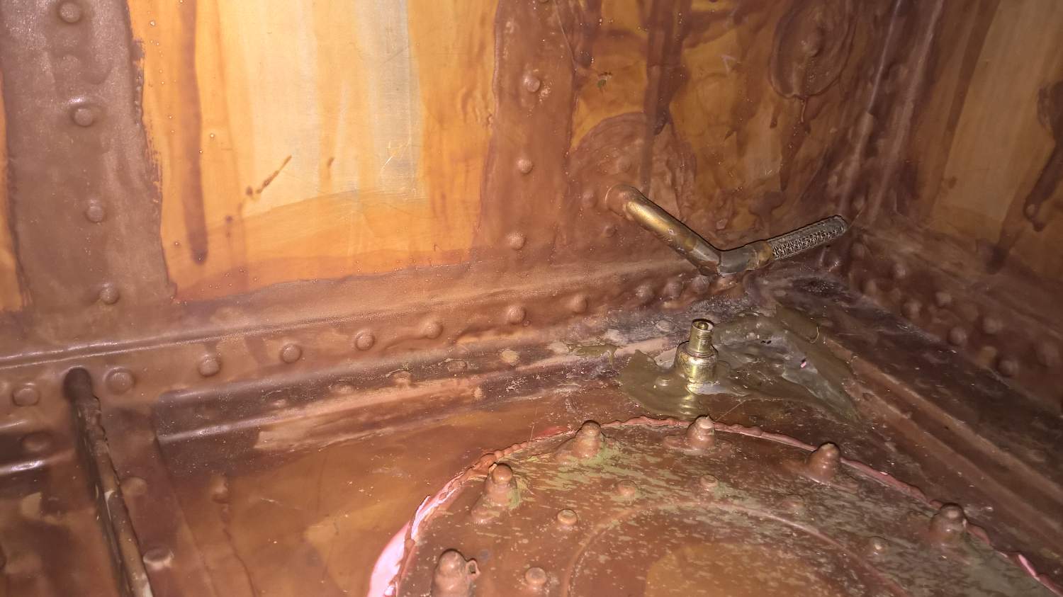

carusoam Posted July 27, 2021 Report Posted July 27, 2021 @Clipper JR left a pic for you! Look familiar? Best regards, -a-

carusoam Posted July 29, 2021 Report Posted July 29, 2021 @Clipper, get a good look at JR’s pic above… And be sure to understand what your mechanic is doing… The height of the intake tube has a lot to do with how well water gets removed from the tank…. The drain is lower than the pick-up… The pick-up shouldn’t draw any undrained water… If the tube changes height in the tank… it will affect the usable fuel onboard… Just some small details your mechanic should know already…. Trust but verify… Looks like the end of the tube has a fastener going through it… this should aid with the removal of the part with the screen on it… Putting it back probably requires a touch of tank sealant, or something similar… PP thoughts only, not a mechanic… Best regards, -a-
