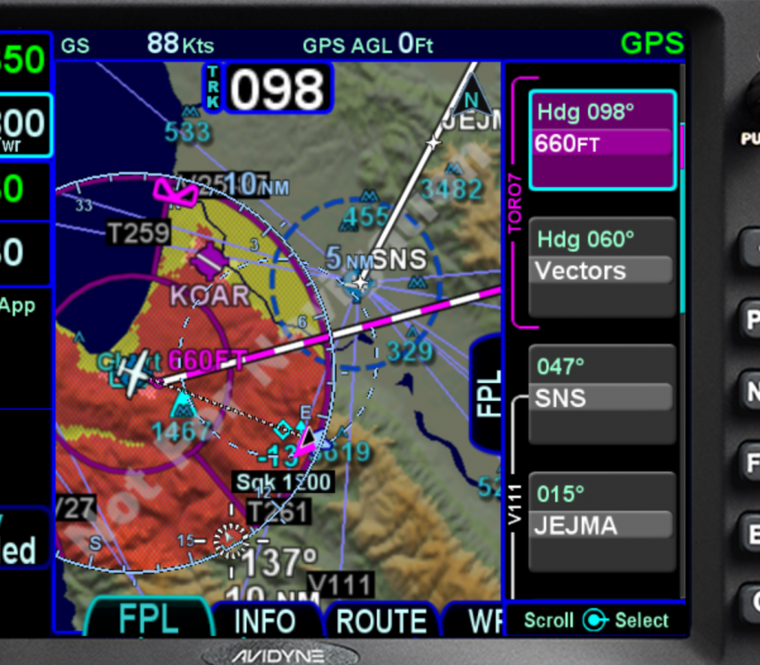

midlifeflyer Posted April 19, 2021 Report Posted April 19, 2021 (edited) It's a pure vector SID with no course guidance. There are a number of them in the US. Most pilots are a bit confused by them the first time they see one. There's no guarantee with these that you will have any transition, although later GPS units have begun putting in dotted lines to transitions - dotted to signify you don't follow them. SNS us not in the database list because it is not identified as a transition fix, just a reference point (crossing the R210) your clearance route came down to: turn left heading 060 expect radar vectors SNS after crossing the SNS 210 degree radial, V111 MOD. Agree with @GeeBee. Whether you bother with the box us up to you. I probably would just out of habit. Edited April 19, 2021 by midlifeflyer 3

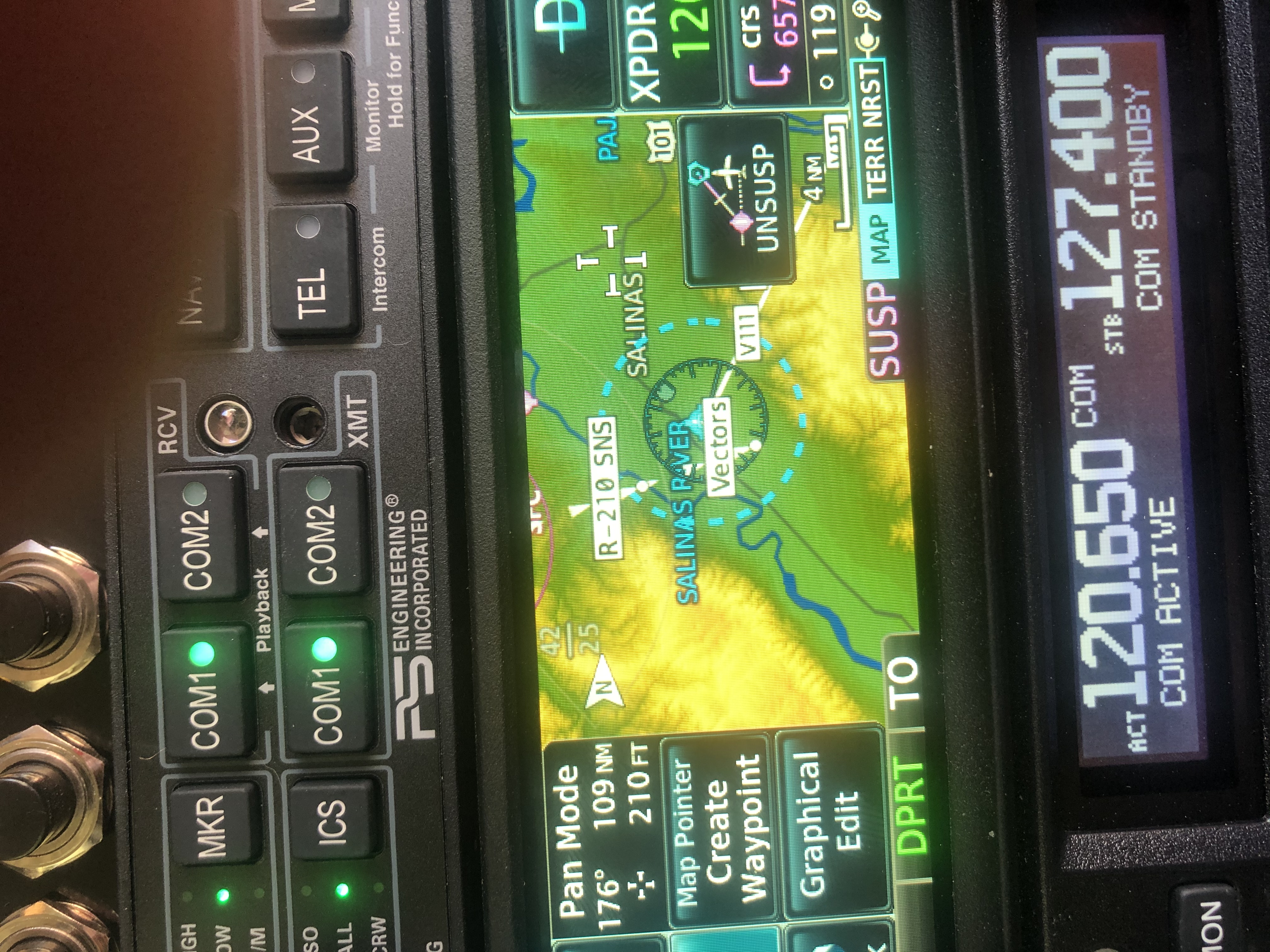

RobertGary1 Posted April 20, 2021 Author Report Posted April 20, 2021 This is on my gnx 375. Nearly identical to the gnc650. Some people pointed out that there is no requirement to load DPs. Which is true but kind of misses the point of trying to understand what Garmin is doing. I think one person said just go direct sns which isn’t correct. So I took a video. I did select sjc just for grins. Then it lets me load the procedure. Shows the heading and the radial intercept for when to expect vectors as the procedure depicts. But of course then sends me out to sjc. But I was able to delete sjc on the flight plan and put in sns and then it all worked. So just a little strange that Garmin requires a transition which the procedure does not. Then Garmin makes me pick from all but one of the vors shown on the procedure (which of course mine was the missing one). IMG_2312.MOV

midlifeflyer Posted April 20, 2021 Report Posted April 20, 2021 BTW, for the Avidyne users, you'll see that it does not have a selection list of transitions for this SID at all. You just enter the next enroute waypoint and get the vector "barber pole." 1
