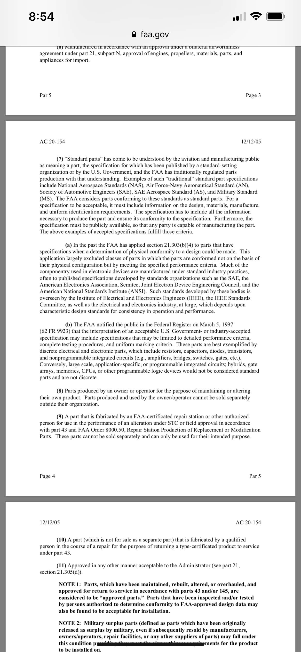

bradp Posted April 17, 2019 Report Posted April 17, 2019 Regarding the Carlisle brand - seems as though this AC would allow substitution of the brand of it adheres to a standard (IEEE etc). Am I reading this correctly ?
201Mooniac Posted April 17, 2019 Report Posted April 17, 2019 It sounds like there will be a new rev 18 of the install manual posted soon that will remove the requirement for the Carlisle wire for most installations.
