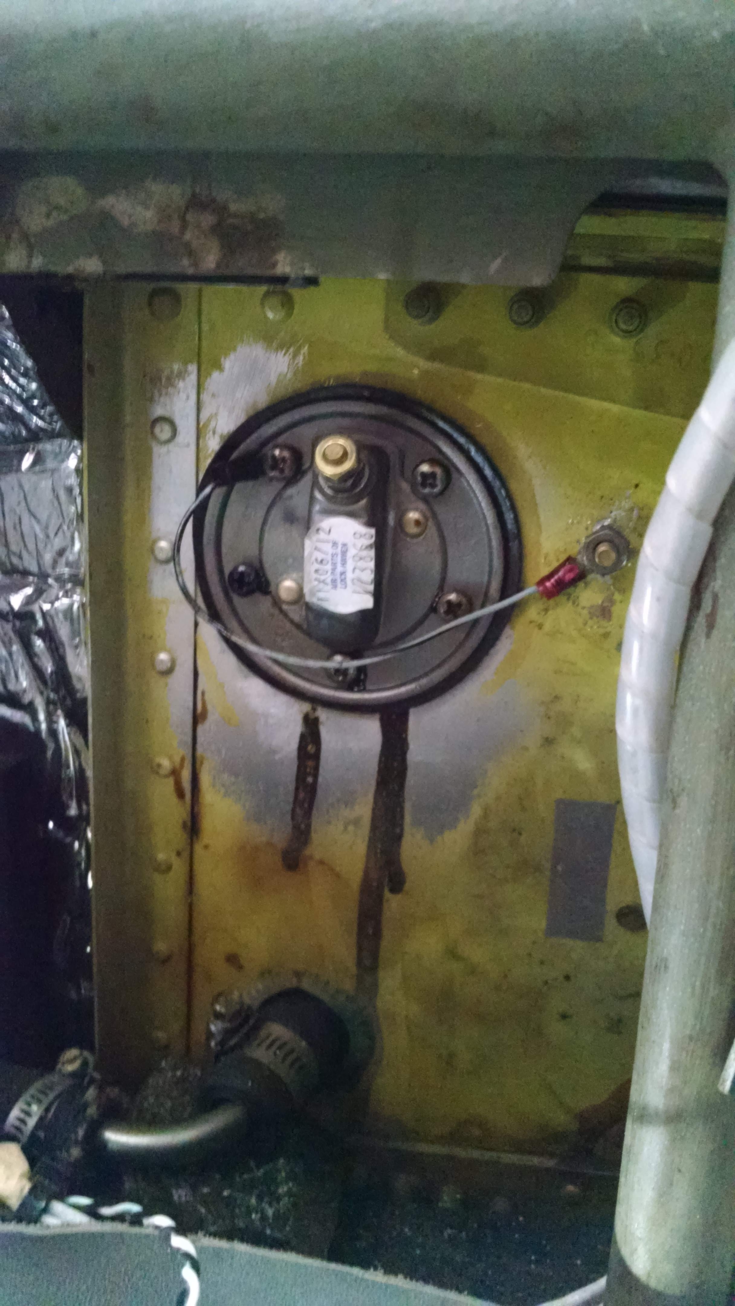

carusoam Posted April 27, 2018 Report Posted April 27, 2018 RG, Not uncommon, but not right either... There aren’t fuel aromas that are emitted as part of normal operations... When a new aroma appears, it is best to find the source... new equals changing... on the other hand, if you are in the camp of old planes smell... my old plane had so much wear and tear and age... everything had leaks... old seals, old fuel hose connectors, enough the carpet was turning blue under my kids feet... I bought the plane that way, so it seemed normal... it isn’t normal. Great pics, Bob! Seal and fuel hose in one! Best regards, -a- 1
