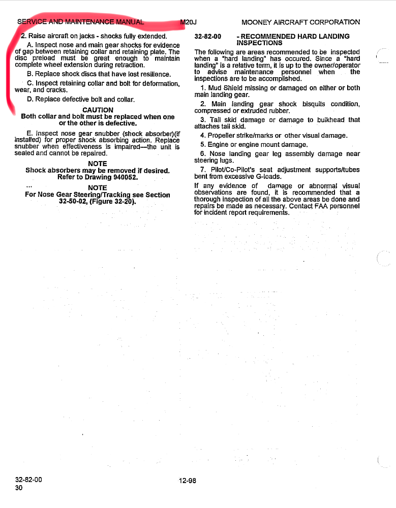

PT20J Posted February 22 Author Report Posted February 22 Paul is correct, and I should have pointed out the second test. Attached is a section from the M20J SMM with the entire procedure outlined in red. No temperature or time limit is specified in the extension test, but since the text states that the gear must be fully extended for retraction, it seems self evident that the delay should be minimal. I highlighted in yellow a note that I find humorous as it describes a critical approximate measurement. 2 1
