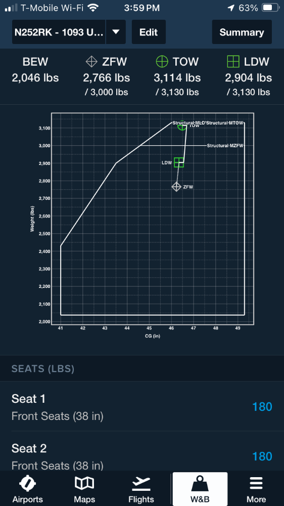

Ragsf15e Posted Wednesday at 11:01 PM Report Posted Wednesday at 11:01 PM 5 hours ago, Trogdor said: I understand that to a degree - but I'm just feeling for if W&B is truly a challenge to fit 2 or even 3 folks in it. I think that is a reasonable ask. Let me rephrase: If you own a Rocket have you flown with 2 adults, how about 3? Do you carry full fuel? Was it a real hassle to get the CG right? Those kinds of things. I have a 252, not a rocket, so maybe this isn’t helpful… I wouldn’t expect to load 3 adults, baggage and full fuel in many (most?) 4 seat airplanes. You will start dropping fuel to make the weights work, however, most Mooneys have enough fuel for 5-7 hours (mine has extended tanks, so ~10 hours total if full). It’s generally not a problem to reduce to 4 hours fuel and still have excellent range. As an example, the 6 seat PA-46T Meridian I fly only has ~550lbs of useful load left at full fuel, but half fuel is very functional. So load should be manageable. Balance, well, the Rocket might be a different animal, however most Mooney’s are very flexible as far as how they are loaded. Much more so than say Bonazas. I can definitely fly two adults in front with no baggage. As an example, here’s a weight and balance with 60 gallons of fuel and 4 x 180lb adults. No baggage. It works fine but it’s a 252, so not a Rocket. As mentioned above, over the years the WB can easily get messed up so if it seems off, it might need reweighed. 1

Pinecone Posted Thursday at 03:54 PM Report Posted Thursday at 03:54 PM 16 hours ago, Ragsf15e said: I have a 252, not a rocket, so maybe this isn’t helpful… I wouldn’t expect to load 3 adults, baggage and full fuel in many (most?) 4 seat airplanes. You will start dropping fuel to make the weights work, however, most Mooneys have enough fuel for 5-7 hours (mine has extended tanks, so ~10 hours total if full). It’s generally not a problem to reduce to 4 hours fuel and still have excellent range. You need to do the Encore upgrade. 230 pounds additional GW. For no change in empty weight (well maybe a couple of pounds). I also have Monroy tanks, but can do two people, full fuel, and still have UL for 50 pounds of baggage.
donkaye, MCFI Posted Thursday at 04:09 PM Report Posted Thursday at 04:09 PM 16 minutes ago, Pinecone said: You need to do the Encore upgrade. 230 pounds additional GW. For no change in empty weight (well maybe a couple of pounds). I also have Monroy tanks, but can do two people, full fuel, and still have UL for 50 pounds of baggage. You're talking apples and oranges. There's no Encore upgrade for a Rocket. The "Rocket" was the upgrade. 2
Ragsf15e Posted Thursday at 04:24 PM Report Posted Thursday at 04:24 PM 27 minutes ago, Pinecone said: You need to do the Encore upgrade. 230 pounds additional GW. For no change in empty weight (well maybe a couple of pounds). I also have Monroy tanks, but can do two people, full fuel, and still have UL for 50 pounds of baggage. I have that. On the WB I posted, mgw is 3130. Empty is 2046. I also have Monroys. I bet our airplanes are within a few lbs of each other.

Ragsf15e Posted Thursday at 06:11 PM Report Posted Thursday at 06:11 PM 1 hour ago, Trogdor said: @donkaye, MCFISomething is off here based on talking with now three other Rocket owners: All of them have reported back with their own sheets and have no issue staying in the envelope with 72 gallons of fuel with even more weight than the scenarios I described. The original Rocket Engineering document says: The takeoff weight is 3,200 lbs. The conversion adds 208 lbs. to the empty weight, moving the CG forward .3". How can the 252 envelope change that dramatically given those changes (someone posted the stock 252 one above)? Just throwing it out there. The sheet also states the constant data is from an M20F but I assume it has been updated accordingly for 252/Rocket numbers? @Ragsf15e Based on Don's sheet, that seems to be the big difference. MGW is supposed to be near 3200 with an empty around 2068 (2046 is definitely inline with that). https://data.ntsb.gov/Docket/Document/docBLOB?ID=40368222&FileExtension=.PDF&FileName=Mooney rocket conversion specs-Master.PDF And that wasn't even with a glass panel which should reduce the empty substantially. These things are pretty easy to “mis-weigh”. Or simply to mess up the math while doing updates to the WB. It happens all the time. There is a very specific procedure in the maintenance manual on how to weigh it and do the math… it’s a little complicated/confusing and people mess it up. I would look at the original factory WB and compare that to the one after conversion to a Rocket. Obviously it will be different, but try to account for anything significant and see if it looks possible. It might need re weighed.
