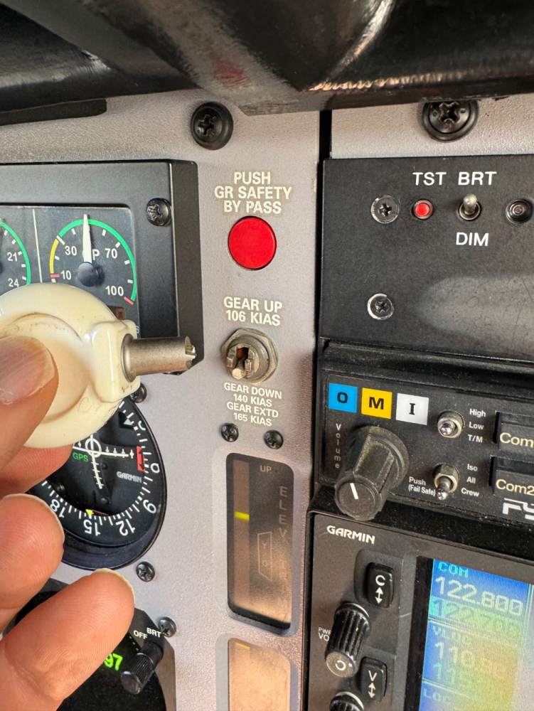

Vance Harral Posted June 12 Report Posted June 12 15 minutes ago, MikeOH said: I sure didn't see ANY evidence of corrosion. Hard to say at low resolution, but looks to me like there is significant brown discoloration at the break point on the shaft. A clean break on an fully intact part would be much shinier, no?
MikeOH Posted June 12 Report Posted June 12 42 minutes ago, Vance Harral said: Look at the picture yourself, from that thread. More than half of the threaded portion of the attach point for the plastic wheel-shaped knob is broken off. This is not just a failure of the plastic. If you want to quibble that a different part of the metal shaft broke vs. the OP in this thread, then sure, it's a different failure mode. Whatever. I thought we were having a rational debate here, but it sounds like you're getting wound up...judging from the 'whatever' comment. To be rational, yes, the exact failure mode is important. The failure mode in that picture would NOT cause a safety of flight issue; you would still be able to raise and lower the gear as the switch itself is intact. I hardly think pointing that significant difference out is 'quibbling'. 47 minutes ago, Vance Harral said: No, I wasn't the guy with my hand on the switch, but I believe my airplane partner when he said he applied only a moderate amount of force. And, I wonder if the OP believes the shop when they say they didn't apply excessive force? 51 minutes ago, Vance Harral said: I'm sure that's true when they're brand new. As I've already explained, I think decades of normal use - with a few incorrect operations exactly as you describe from time to time - can fatigue the metal I think that is a worthy point. Was it fatigue (supports your theory) or over-stress (supports my ham-fisted theory)? Not sure what it would cost to have an analysis done to determine fatigue, over-stress, corrosion, ? I can understand the OP not wanting to bother. 54 minutes ago, Vance Harral said: But I guess everyone who broke the gear switch - the OP's mechanic and my airplane partner and JTR's wife included - are all ham-fisted Yes. 55 minutes ago, Vance Harral said: As I recall, you're the same guy who keeps arguing that properly lubricated landing actuator gears will also never wear out. Ok, THAT is NOT true. You are one of several who choose to overstate my position. Honestly, I previously would have given you more credit than that. My contention is that PROPERLY maintained landing gear actuators will last a very long time (mine is over 5 decades old and still passes inspection). THAT is nowhere near your false claim that I said they'll "never wear out". Please quote any post where I said that, if you believe otherwise. Finally, this latest 'argument' is pretty irrelevant to the present topic: to my knowledge landing gear switches in our Mooneys do NOT require any maintenance or inspections.
MikeOH Posted June 12 Report Posted June 12 9 minutes ago, Vance Harral said: Hard to say at low resolution, but looks to me like there is significant brown discoloration at the break point on the shaft. A clean break on a fully intact part would be much shinier, no? As I said, just my opinion that it does not look like corrosion. Also my opinion that fractures typically are NOT shiny, but grainy. Again, I am NOT a metallurgist. I fully acknowledge that having an expert rule on this would be VERY valuable.
JTR Posted June 13 Report Posted June 13 Found the old picture of mine broken off. Total cost to get a used switch installed was $545.00. Switch was 375 including tax and shipping, took my mechanic 2 hours to change it out. It looked like die cast metal, like from an old hot wheels car.
Paul Thomas Posted June 13 Report Posted June 13 3 hours ago, Vance Harral said: Hard to say at low resolution, but looks to me like there is significant brown discoloration at the break point on the shaft. A clean break on an fully intact part would be much shinier, no? Being all the same color indicates to be it all separated at the same time. I don't see evidence that it was cracked or corroded. 1

Echo Posted June 13 Report Posted June 13 On 6/12/2025 at 12:16 PM, Vance Harral said: Broken gear switches like this are not unheard of. We added a member to our airplane partnership many years ago who managed to snap the switch off on his initial training flight, just like is shown in the OP's photo. Yes, the damage occurred because he didn't fully understand the pull-out-to-unlock mechanism of the switch, and broke it while trying to raise the landing gear (which fortunately resulted in the gear remaining in the down and locked position). But he's not the first person to break a Mooney gear switch, and I think it's likely the switch shaft gets fatigued over time even in normal operations. I'm sure someone will argue the switch lasts indefinitely with gentle use. But I think it's fair to criticize the design. The fact there have been multiple incidents of switches breaking is a legitimate design issue. Other gear switches in other aircraft are considerably more robust, albeit at the expense of being larger and heavier. The fact that multiple stuff is not necessarily from bad design. More like bad instruction and adrenaline. 1
EricJ Posted June 13 Report Posted June 13 48 minutes ago, 201Mooniac said: I was told this is an equivalent switch https://skygeek.com/military-specification-ms24659-23d-switch-toggle-2-pole.html Looks like it has potential, and an MS part number. It's cheaper from Newark: https://www.newark.com/honeywell/ms24659-23d/switch-toggle-dpdt-20a-277v/dp/61M4738 Somebody could 3d print a wheel handle to go over the switch part.
Fly Boomer Posted June 14 Report Posted June 14 1 hour ago, EricJ said: Looks like it has potential, and an MS part number. It's cheaper from Newark: https://www.newark.com/honeywell/ms24659-23d/switch-toggle-dpdt-20a-277v/dp/61M4738 Somebody could 3d print a wheel handle to go over the switch part. I vaguely remember a topic from a few years ago that said some part of the toggle comes off and is replaced by the wheel. This may be what I'm remembering https://mooneyspace.com/topic/28813-gear-switch-replacement/ And here is the part about removing the tip https://mooneyspace.com/topic/50410-anyone-have-the-part-number-for-gear-down-actuator-switch-1976-f/
toto Posted June 14 Author Report Posted June 14 7 hours ago, IvanP said: This switch may be hard to come by. LASAR may be able to source a new one but it will not be cheap. BAS may be an option for salvage. They have couple of switches that may fit your need. https://baspartsales.com/8906k2875-cutler-hammer-landing-gear-toggle-switch/ The shop found four different sources for the switch, and the one they ordered was new-old-stock. They just put in the new switch today. The shop ended up covering this as a warranty repair, since it wasn’t obvious how the damage happened but it happened during their inspection. It’s a positive outcome and a stand-up attitude from the shop, which I definitely appreciate. Thanks to all for your input - I leaned a lot from this thread Thanks also to the MSer who offered me a switch from their aircraft - I might very well have needed that. 7

toto Posted June 15 Author Report Posted June 15 3 hours ago, N201MKTurbo said: just use your pen to push that stub up and down. I’d think you would need the needle nose to pull the stub out before you could move it up or down? 1
Hank Posted June 15 Report Posted June 15 3 hours ago, IvanP said: . . . looking for and fiddling with tools while flying the plane. I'm an engineer, fiddling with tools is second nature. I can reach into the pocket on the front of my seat and pull out a tool without looking, and only reaching with one hand (either one). I've done the emergency gear extension for real once (electrical failure, not a broken switch). It's not big deal; neither would be grabbing a broken switch with a Leatherman--and it would be quicker. Emergency Extension would make a good Plan B. Ever how you get the gear down other than just flipping the switch, do it in level flight away from anything and everyone. I leveled off above MDA and headed away from the hilltops.
Rusty Trombone Posted June 15 Report Posted June 15 Looks like resolved. For future reference and own research. All disclaimers apply. In researching, found that metal hat on this switch screws off, and Mooney “wheel” handle screws on. 2
N201MKTurbo Posted June 15 Report Posted June 15 1 hour ago, toto said: I’d think you would need the needle nose to pull the stub out before you could move it up or down? The locking mechanism is in the part that broke off. You would be able to push it up and down without pulling it out. 3
toto Posted June 15 Author Report Posted June 15 7 minutes ago, N201MKTurbo said: The locking mechanism is in the part that broke off. You would be able to push it up and down without pulling it out. Interesting, thank you
201Steve Posted June 15 Report Posted June 15 9 hours ago, Rusty Trombone said: Looks like resolved. For future reference and own research. All disclaimers apply. In researching, found that metal hat on this switch screws off, and Mooney “wheel” handle screws on. And it’s got loctite in the little crown. 1
PT20J Posted June 15 Report Posted June 15 9 hours ago, Rusty Trombone said: Looks like resolved. For future reference and own research. All disclaimers apply. In researching, found that metal hat on this switch screws off, and Mooney “wheel” handle screws on. The Mooney switch is made by Cuttler-Hammer (Eaton). You’d want to check that the Honeywell part is compatible.
