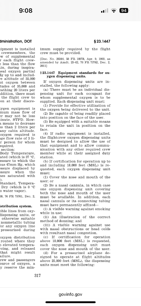

Aaviationist Posted June 23 Report Posted June 23 (edited) 15 minutes ago, N201MKTurbo said: You are correct, I can’t find one. The FAA brochure I posted says the regulations require a mask above 18000, then they post 91.211 but it doesn’t mention it. I have always been taught that, but where is the reg? 23.1447 which also states - there must be an individual dispensing unit for each person - which the aviation version of the Inogen has, but the medical one does not. Provide effective utilization of the oxygen being delivered from the unit - which again for the Inogen - above 14k for 2 people it doesn’t matter where not, and for 1 person above 18k it doesn’t matter not. Edited June 23 by Aaviationist
N201MKTurbo Posted June 23 Report Posted June 23 25 minutes ago, Aaviationist said: 23.1447 which also states - there must be an individual dispensing unit for each person - which the aviation version of the Inogen has, but the medical one does not. Provide effective utilization of the oxygen being delivered from the unit - which again for the Inogen - above 14k for 2 people it doesn’t matter where not, and for 1 person above 18k it doesn’t matter not. That applies to built in equipment. It doesn't apply to portable systems. 1 1

Aaviationist Posted June 23 Report Posted June 23 (edited) 19 minutes ago, N201MKTurbo said: That applies to built in equipment. It doesn't apply to portable systems. While that’s true, it really becomes a question for the FSDO. And I’d bet the FSDO gives you a solid no. I’d encourage one of you to call and ask (and relay the full conversation, not just bits and pieces that only support your position) 8 minutes ago, N201MKTurbo said: At this point I have spent 23 years of my working life as an engineer for FDA regulated medical device manufacturers. Inogen is a regulated medical device manufacturer. They cannot recommend in any way that their devices be used for any off label use. I'm sure that is why they made an aviation version. It is probably not marketed as a medical device and therefore not regulated by the FDA. They cannot approve of anyone using any of there medical devices for aviation use, because that is not what it was designed and approved for. Even if they are the exact same device. None of these regulations apply to the end user. if you buy one, you can do anything you want with it. Except they DID briefly make and support an aviation version that had 2 outputs. This is where those altitude limitations came from. Again, where has the FAA ever allowed you to use ANYTHING to meet a regulatory requirement that directly contradicts the manufacturer guidance? never. Edited June 23 by Aaviationist
N201MKTurbo Posted June 23 Report Posted June 23 11 minutes ago, Aaviationist said: While that’s true, it really becomes a question for the FSDO. And I’d bet the FSDO gives you a solid no. I’d encourage one of you to call and ask (and relay the full conversation, not just bits and pieces that only support your position) Except they DID briefly make and support an aviation version that had 2 outputs. This is where those altitude limitations came from. Again, where has the FAA ever allowed you to use ANYTHING to meet a regulatory requirement that directly contradicts the manufacturer guidance? never. If there is no regulation, then there is no regulation. You haven't shown me one yet. If you are curious, contact the FAA and ask them what the regulation is.

Marc_B Posted June 23 Report Posted June 23 6 hours ago, Aaviationist said: 23.1447 which also states - there must be an individual dispensing unit for each person - which the aviation version of the Inogen has, but the medical one does not. I think the FAR is defining a dispensing unit as the mask or cannula. i.e. I have one oxygen cannister built in, but I have 4 outlets that allow 4 cannulas (one for each occupant). 1
Aaviationist Posted June 23 Report Posted June 23 4 minutes ago, Marc_B said: I think the FAR is defining a dispensing unit as the mask or cannula. i.e. I have one oxygen cannister built in, but I have 4 outlets that allow 4 cannulas (one for each occupant). In a pulse system like the Inogen it would not be unreasonable to say that using 2 cannulas attached to one output counts as 2 dispensing units. Again, that’s a question to ask to FAA. I personally think it is unreasonable to think splitting the output of a single pulse based output is a good idea.
Marc_B Posted June 23 Report Posted June 23 22 minutes ago, Aaviationist said: I personally think it is unreasonable to think splitting the output of a single pulse based output is a good idea. I think what you mean is that "homerolling" your own cascade might be problematic. (i.e. if resistance/length/tube diameters/etc weren't considered you might get differential flow rates) However, I think if you used a cannula cascade that was designed for equal flow then I think it's feasible. If you consider that you're using one oxygen canister with standard built in oxygen, using one canister with a Precise Flight or Mountain High portable oxygen set up.... But you also have to realize the failure points with ANY oxygen system you use. The failure points of each set up has it's own merits...built in, portable, pulse demand vs continuous flow, etc. But for people using supplemental oxygen at 10-15,000 ft MSL...the FAA Time of Useful Consciousness is indefinite. Meaning the FAA won't care what oxygen equipment you use below 15000 ft MSL. You have more likelihood of CO poisoning than significant altitude (hypoxic) hypoxia at these altitudes. Time of Useful Consciousness 15,000 feet — Indefinite 20,000 feet — 10 minutes 22,000 feet — 6 minutes 24,000 feet — 3 minutes 26,000 feet — 2 minutes 28,000 feet — 1 minute 30,000 feet — 30 seconds 35,000 feet — 20 seconds 40,000 feet — 15 seconds
